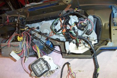

The cluster frame is grounded to the dash frame via it's mounting screws. The dash frame is grounded to the body the same way. There is also a harness ground as shown bottom right. Then there is also column ground jumper at it's dash mount.
mopar marks, what i said above, could i have a problem elsewhere that would do such a thing? i never had this happen before and just charging the battery fixed the problem, i don't understand how, or why.
any dash bulb ( or any bulb for that matter) with one wire on it grounds thru the springy clips that hold it in. the twist in black plastic dash bulbs ground thru the circuit board which in turn grounds to the dash itself .
