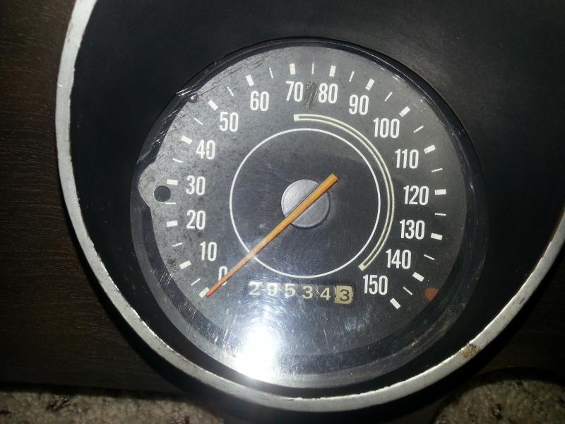

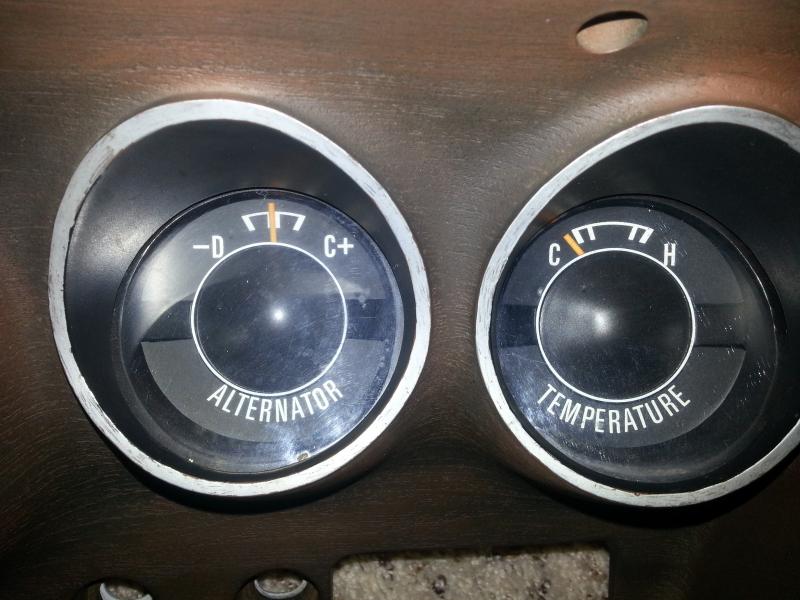

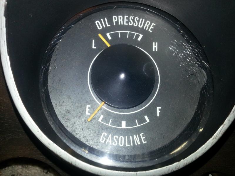

Here are some pictures. I'm looking for some affordable replacements but its not so easy. How I love Mopars but darn they are so bleeping expensive to fix. Thanks for all your help.

I don't have that year cluster so I'm not familiar with them. Are the plastic lenses flat, or domed? If they're flat, go to home depot and get a sheet of lexan and cut out some new ones.
I would say you need some new ones, I don't know how you could clean those up. Check with BE@A are Herb's and see if any one is making these yet. If not just watch E-bay and find you a decent set. Good Luck Ronnie

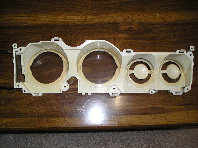

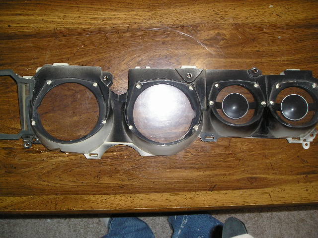

Here is a couple pictures of the lenses and amp gauge I have.
Mike

You can remove them easily by picking away at the very thin plastic that is holding them, which reveals the post. They can be gently pryed up and will come off. Once they are off, you can easily polish them on a bench or a with a wheel.
To re-install, just set them over the posts and put a small dab of clear silicone adhesive on the holes to hold them in place.

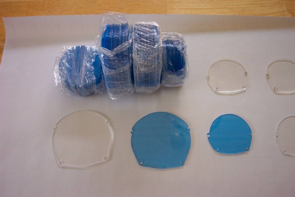

I bought a set off him for my dash for my charger for 20 bucks but I think he only had a few sets left when I bought mine and that was over a year ago
