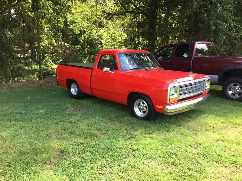

The 440 in my '84 pickup needs to be freshened up. Can anyone tell me which RB heads have hardened exhaust seats?

I know folks will think I’m nuts by saying restore the old ones but thats what I did with my 906s... of course I wanted the originals and we put all new guides, seats etc. I’m chasing the pure stock class with this car though. 452 will definitely get the job done though. I like your truck, looks good!
