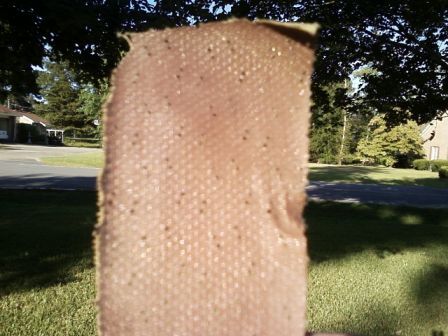

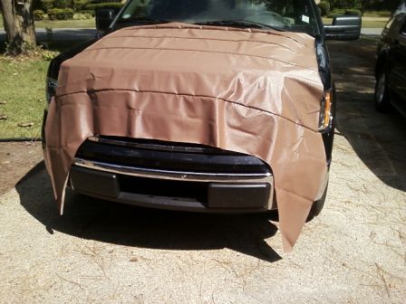

I needed to dye my headliner in my 67 GTX. It has a copper interior and everything in the interior is a different color of tan or brown. I had a small peice of the origional headliner and scanned it with a DuPont Chromavision color camera. The jobber then mixed up some vinyl color to match. It was close and we tinted it a little closer. See if your local paint supplier has the scanner and take the car to the store and scan the panel.
Here is the sample I scanned and the dyed headliner
