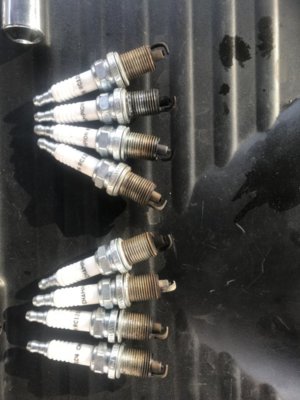

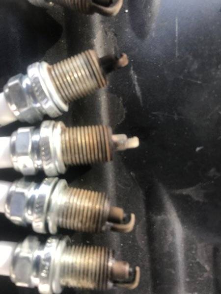

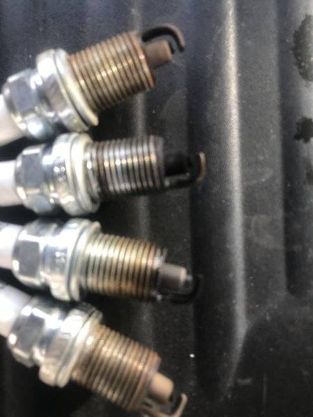

Ok my friend called me this morning and said he was broke down and had his Ram hauled to my house. Smells foul of unburnt gas. 3 or so weeks ago I installed new injectors for him and it has been running fine until today. I pulled all of the plugs and layed them from left to right 1,3,5,7,2,4,6,8 I was thinking a couple leaking fuel injectors. Its hard to start and takes a few seconds to start almost like its either flooded or no spark. Anyhow Im posting these pictures of the plugs maybe you guys will know what these plugs show. Edit sideways pictures now are top to bottom 1 through 8.
1 dry
3 black sooty
5 kinda wet
7 dry
2 sooty + crusty stuff on it
4 dry
6 dry
8 dry

That said, #s 3 and 2 are fouled/either soot or oil, 5 is on the way there(could be from the misfire) Others look a little rich at idle , but tough to tell with them being reddish colored, usually from fuel cleaners/additives/octane boosters. Can't see what it's doing much at cruise and WOT with the threads on though. Interesting for an injected vehicle... all sensors clean and properly functioning?

Here is something I checked. I took out all the plugs and turned the engine over a few times. number 4 cylinder was gushing out gas. I suspect that injector took a dump. None of the other cylinders was dumping gas like that one. It was so bad it was pouring out of the spark plug hole. Pretty sure I have the problem figured out. But why all the other fouled plugs? Number 4 Does look like it was cleaner than the others.
So would it be possible for one injector to cause this on other cylinders? The only thing I can say to make sense would be. Number 4 gushing gas caused low pressure on the others? Does that make sense?
