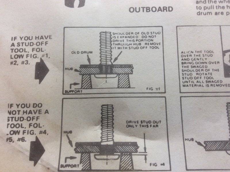

I know that the FRONT wheel studs need to be removed carefully because of the swaging and I will let someone else do that. Are the REAR studs swaged or can I knock them right out of the axle flange. 1964 Sport Fury. Thanks!
There is no harm or danger in knocking out the front studs. Actually they're knurled, not swaged.

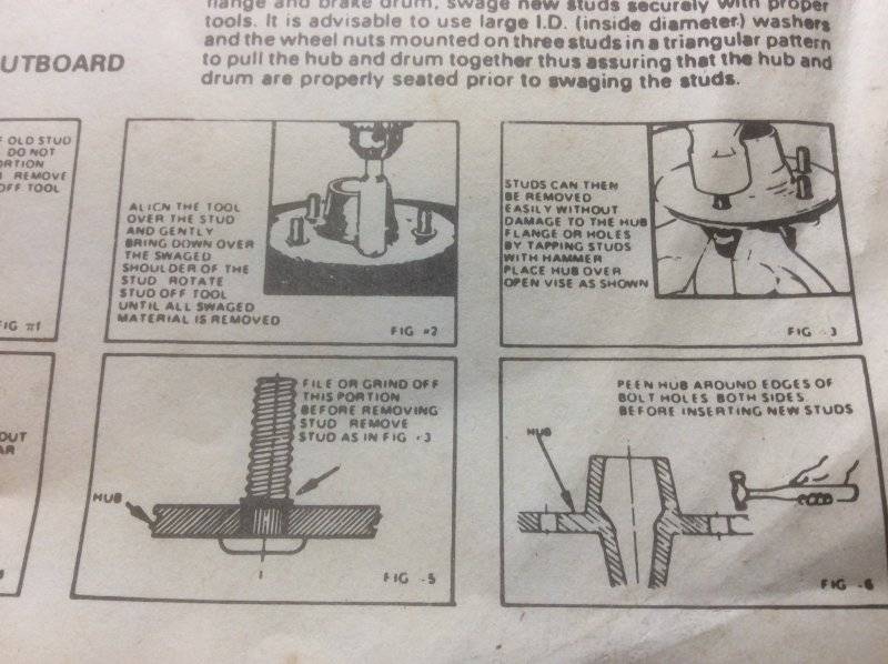

With the swaged ones you can carefully grind off the swages with an angle grinder and they'll come out.
You are incorrect sir many people have wrecked hubs by not cutting out the swage first with the cutting tool . After that yes, just knurled press into place.
A 1964 8 3/4 will have swaged studs, unless they have been modified.
Thank you. I'm sure it's never been modified. I noticed that the replacement studs are not splined so that makes sense. The new ones will have to be swaged on?

They do not need to be swaged, that was to hold the drum on.
Agree with above. I would not swage them. Google hotrodsandhemis, there is an article with pictures on that site.
If you remove studs from from hubs the hubs need to be supported from underneath. Not supporting hub could cause hub to become warpped. There are usually 4 places at the base of threads that need some grinding.
