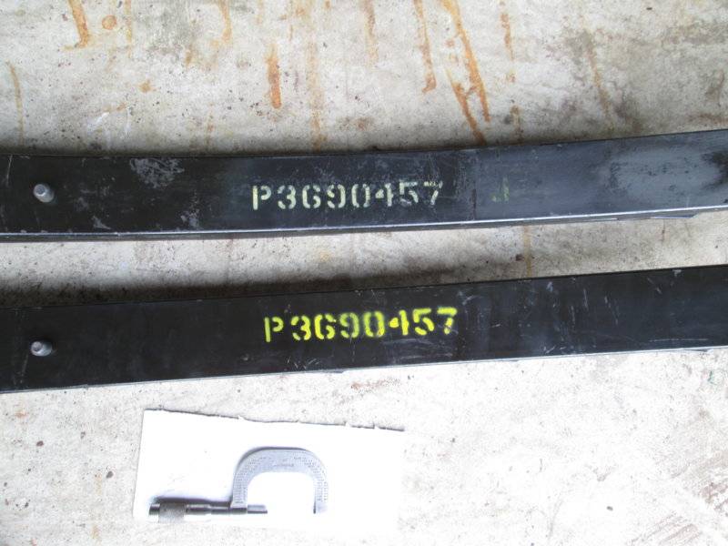

Just wondering what length U-bolts for a Dana Rear End, when using MP Super Stock Springs on my '63 build ? My parts are scattered right now to get an accurate measurement, Thanks...
The B-Body Dana equipped cars used a 7 & 1/8" U-bolt and the 8 & 3/4" cars used a 6 & 5/8" U-Bolt. I would think that the 7 & 1/8" style would be fine unless mentioned above, extra shims etc.
