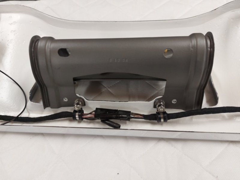

It gets two 7/16” bolts throught the bumper holes to catch the J nuts the license bracket should get.
Tight to fit with the license light assembly in the middle.

sorry, I am not understanding. there is the license plate, the bracket for the license plate to attache too (4 screws) and it has the spring assembly on it that attaches to another bracket that goes to the bumper. The bracket that goes from the bumper to the plate bracket with the spring that allows you to pull up the plate and access the fuel neck is what I am looking for. or any solution to maintain the functionality of the play being lifted up and accession the fuel neck will suffice.
Thanks
Check the pic I probably posted while you quoted me. Note the top ends with the screws attached and look closely the license plate assembly it gets two J nuts. These are catched by the mentioned bolts throught the bumper holes
what Dows the other side of the plate bracket look like? that is not what mine looks like

This assembly is upsided down but I hope you can see how should look from behind… bolt ends are visible
Both are 73/74, but pretty sure 71/72 are the same (diff should be just on bottom bracket, 73/74 is wider)

that black part is what I need, it is not on my license plate holder
Well… you need to get another assembly then. Easier than get just the part you are searching

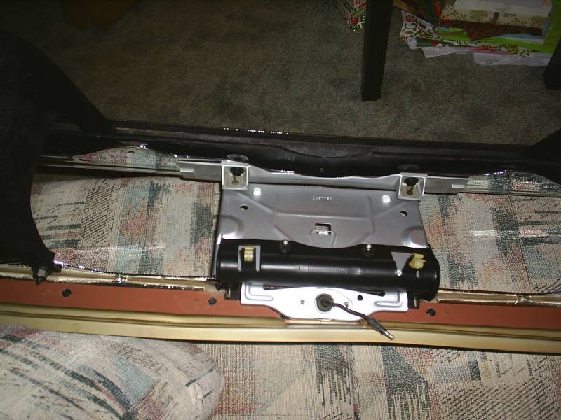

I went through an old video of me taking the car apart and this is what it looked like. Picture below. The one you provided from eBay will not work. If I place the license plate bracket on the bottom two round rubber stops the bracket I have today is way higher than the number. Not allowing me to attach it. Not clear on why so different. Yes have a light bracket there as well.
This is what I mean
Did you tried with light assembly in place?
73/74s (or at least those 73/74 I have worked on) doesn’t have that extra surface on license bracket, so I can install without deal with the light.
The only difference is try to fit with or without light in place. That’s all.

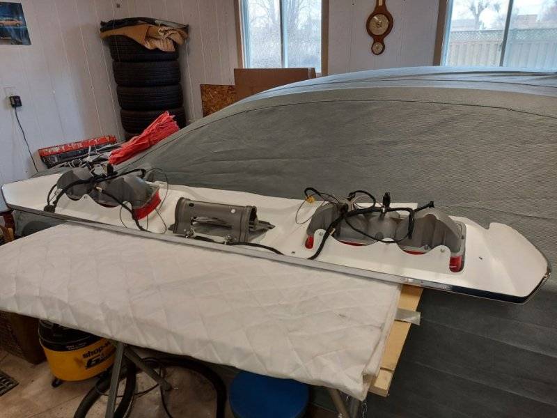

I would buy the one 71beeper has but the bumper in the picture looks super aftermarket. So I risk it does not fit.
