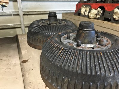

Charlie,
I just bought a pair from Oreillys a couple months ago and they are finned....Hence, is why I specifically purchased from them

Just checked Oreilys and they have them for 62 bucks each.

ALL Currently manufactured 11" x 2 1/2" Brake Drums are Finned ---- No One has had Plain 11" x 2 1/2" Rear Brake Drums
in over a decade.......

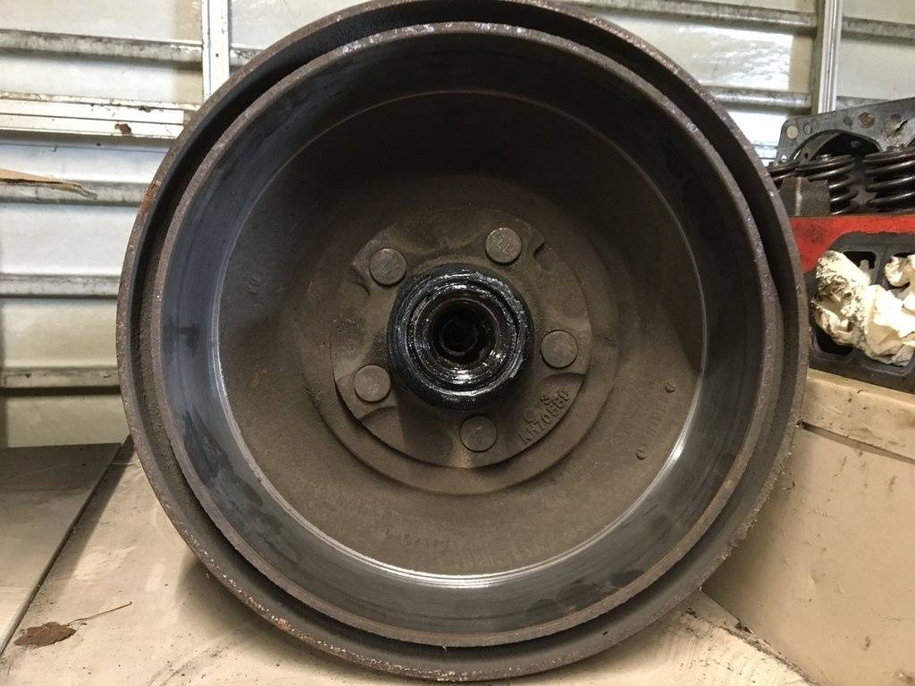

I'm curious about this also because I've been in search of non-finned drums for my 68.
I'm almost positive that the finned drums will work fine...in fact I probably have a set to confirm that, but haven't yet.
I also have the non-finned drum, but they are over size and have some chips where folks beat them off in their past life.
As mentioned, and is obvious, finned drums will cool better, but I'm looking for a more OEM correct look.

Classic #1938. I got replacements for my 68 from a rep. for a parts supply place. I don't remember the originals being finned, my fronts are original( 3") and are not finned.Its been a long time since replacement of the rears,but I'm the original owner.
