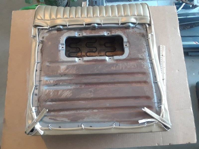

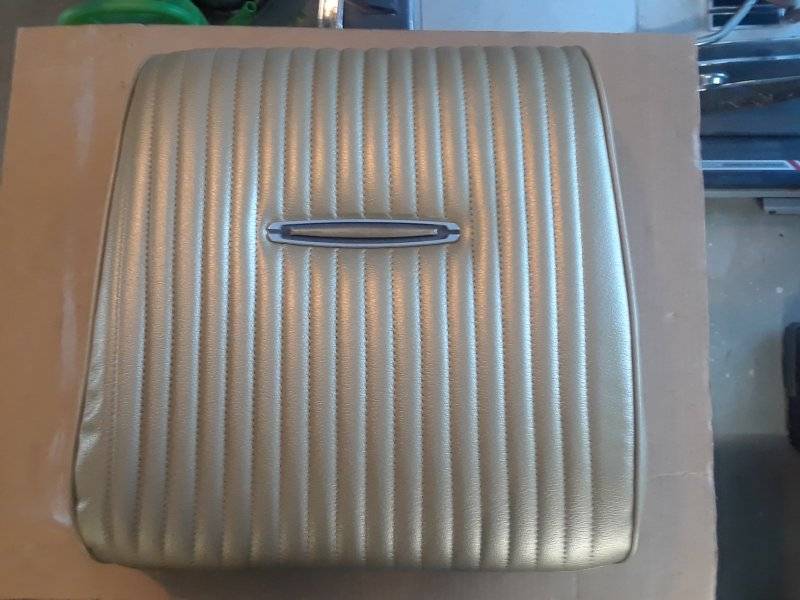

I had similar issues when recovering mine. One side was good, I was able to reuse all of the original tabs, but the other seat was in rough shape.
What I did on the back panel was to drill a small hole and wire the cover down using a thin loop of wire, twisted at the end to secure it in place like a hog ring. The wire was thin enough not to cause any issues. The same seat had broken tabs on top as well, but that was an easy fix. I simply used a few small hex head sheet metal screws the hold down the fabric . The screw heads were between the raised ribs at the top, so they didn't interfere with anything.
Sorry, no pic's unfortunately...
The finished product turned out well however :thumbsup:

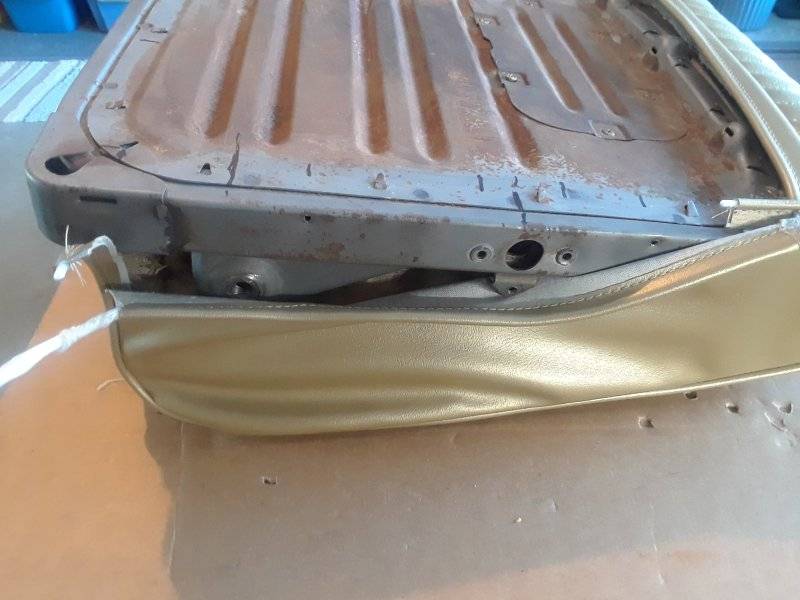

Looks good. I ended up using 3/4 inch S hooks. Inserted a flexible listing cord into the folds on the vinyl cover to give more strength. Then used the S hook like a hog ring and then hooked into the spot were the broken tab was. Had to drill a small hole in most to insert the hook. Will have pictures when done.
That'll do it... as long as the hooks don't sit up high enough to interfere with the installation of the carpet assembly and trim, you're good to go.
Was a thought I had too. A cardboard spacer goes down first then the carpet so it will clear the hooks ok.

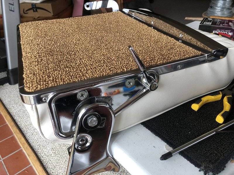

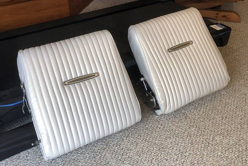

We just finished our 66 with pearl white and used aluminum pop rivets with washers
