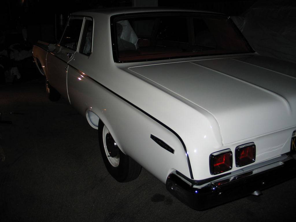

I'm not sure how similar the 64 fury's is, but here you can see the rubber guards on my 64 Dodge between the bumper corners and paint.
Thanks for the pic.. it makes sense to me now. I need to do some checking a see what they actually look like. Thanks guys.
