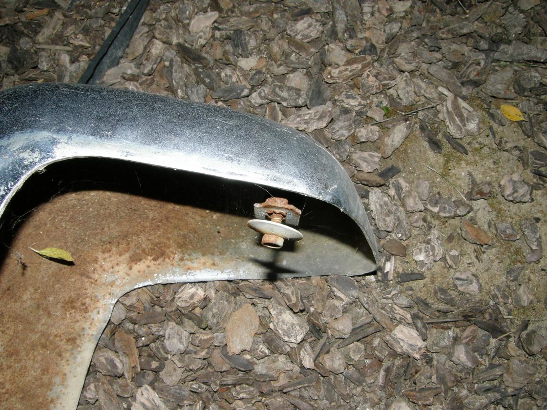

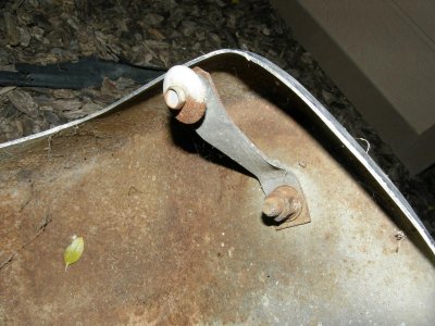

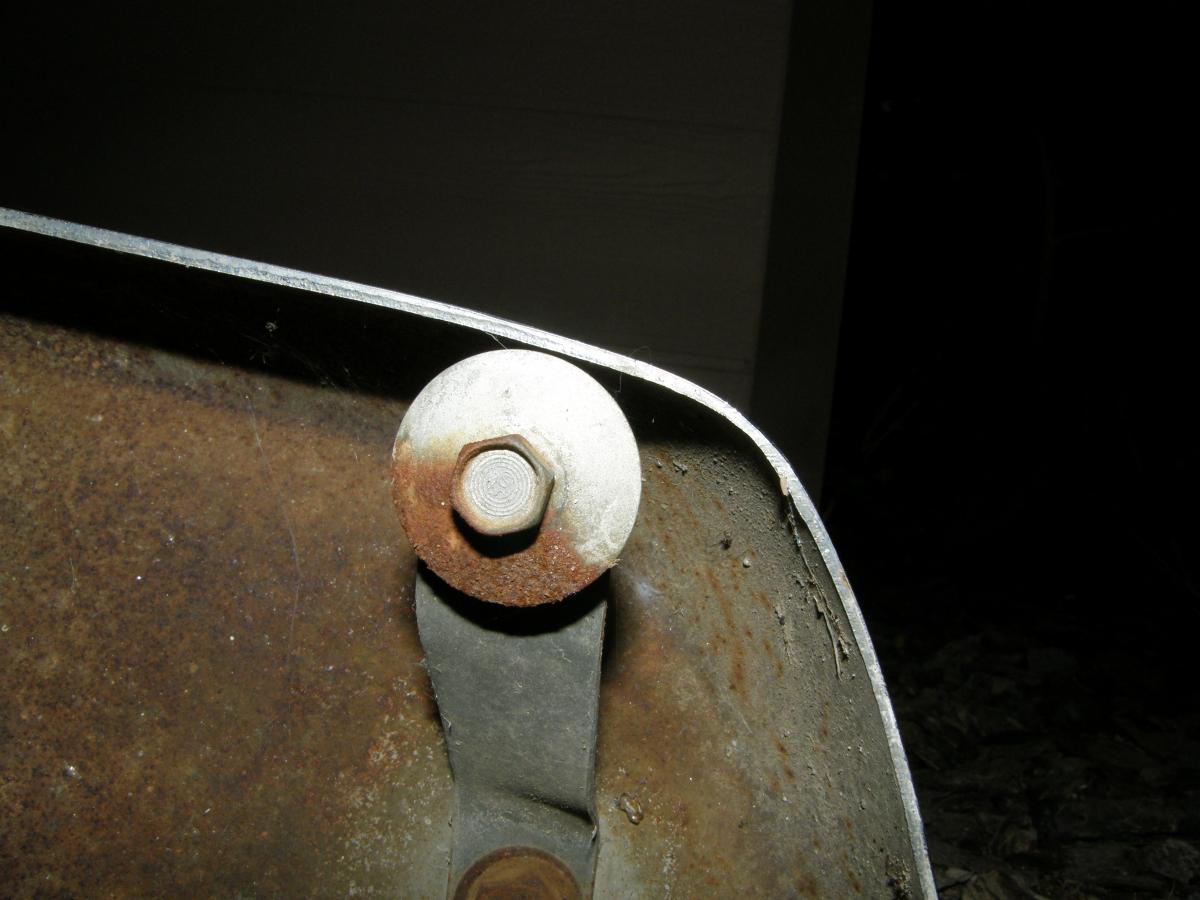

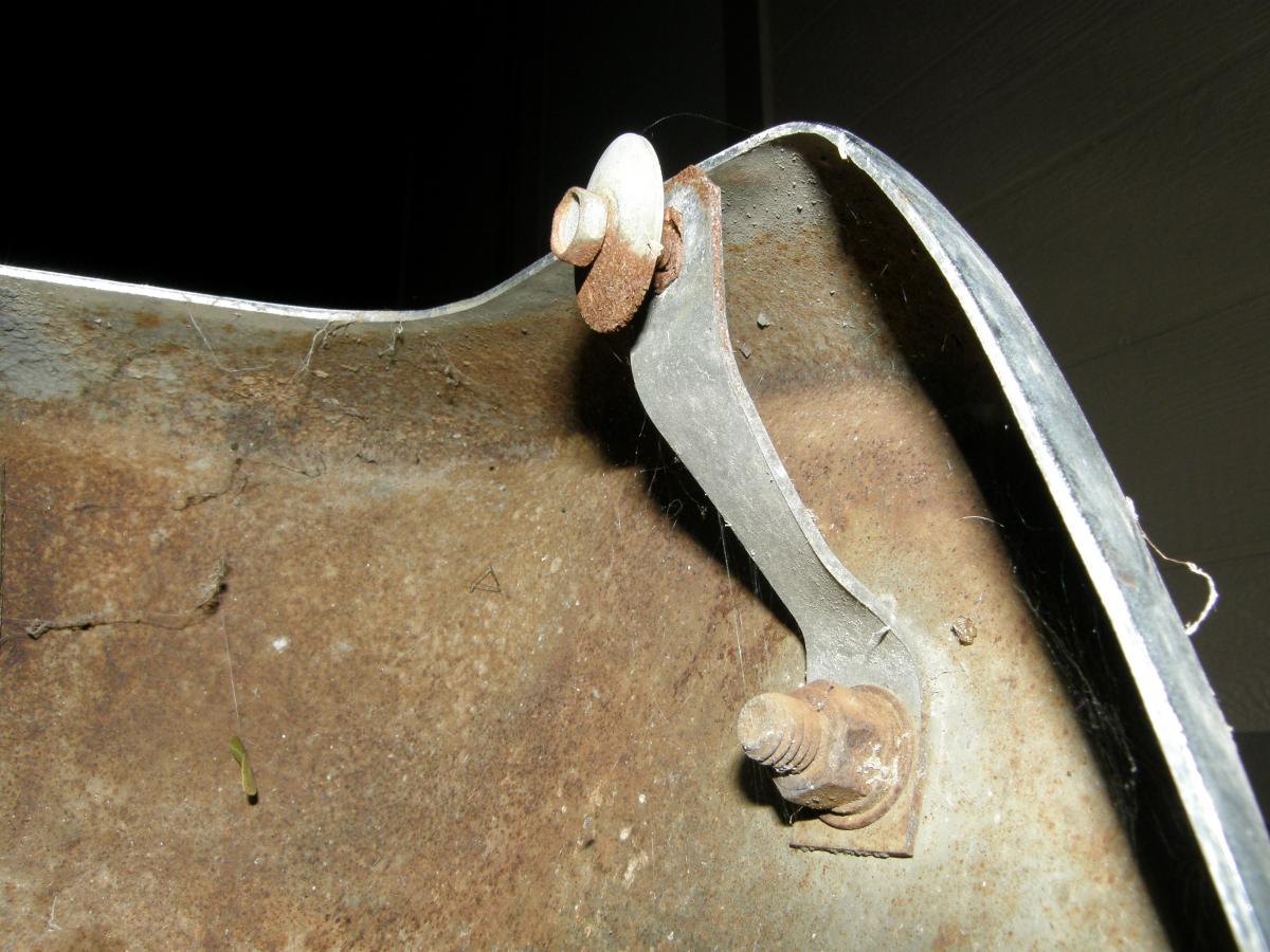

Does anyone have a picture of the bracket that connects the rear bumper through the rear quarter on a 64 polara, 440, or 330? I think I have the brackets but I'm thinking that there should be some kind of rubber grommet that gets bolted through the body to the bracket.
I'd appreciate if someone could post a picture of this area or could give me a link to someone that deals in these.

Joe, as we speak I have my rear bumper out and there is a rubber thing on there. If I can find the camera (wife put it in her closet, so it's lost forever) I'll snap some pics for ya and post them up.
That would be great Zack. A picture or two of the bracket and the bolt holding the bracket to the car would also help me. Thanks. I thought you bought a fiberglass bumper for your car?

The bumper attachment thingy...
Here ya go Joe, hope this helps.

Thanks Zack. I do have all that hardware and figured that it was for there although I was thinking that there should have been some sort of rubber grommet going through there also so you wouldn't have metal to metal contact with the rear quarter.
I'll pick up some big rubber washers or something to accomplish that.
I dont remeber any rubber being there, but you do have a good idea I'm gonna have to steal, hope ya dont mind.
