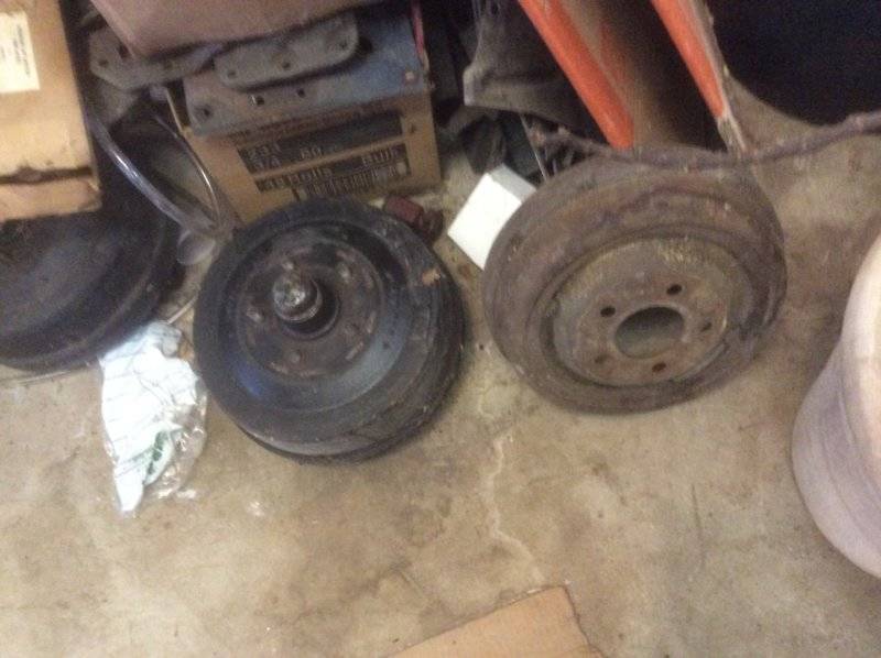

When l bought my 70 Roadrunner in 2013 it had drum brakes. One of the first things l did was do the front brake conversion and swapped out my 11" x 3" drums for discs. A year later l bought a Dana 60 for the car and converted to disc brakes in the rear also. I sold my 8.75 complete drum to drum so l don't have them to use as a reference. My question is this, did Chrysler use 11" x 3" in the rear as well as in the front?
The reason l ask this is because l have a 1963 Sport Fury that l occasionally race and although l have 4 piston 11" discs in the front, it only has 10" x 2.5" drums in the rear. I saved the 11" x 3" drums and shoes from the front wheels on the Roadrunner and l would like to use them on the rear of my Fury. I have sourced a set of 11" back plates and I'm wondering if any of you guys have tried using or know someone that uses 11 x 3 drums on the rear axle of their B body? I see plenty of listings for 11 x 3 in the front but only 11 x 2.5 in the rear. Thanks!

Measured dia of front 11" brake hub 2.810 +/- .010. Rear 2.815 same +/-.
Wonder if you look on rock auto and see if the part numbers are the same. Notice how I passed on that to you.
This is interesting....so....do you think the 11" front drums are the same as the 11" rear drums???? (I'm guessing I'm wrong on this, but I have to ask)
Went to rock auto center hole spec larger on rear 2.836" front 2.813".
I found this on the 10" drums also. They look idential for the exception of the center hole. You don't want to use a rear on the front. They do fit loosely on the hub.
You think ma would have made them the same?
