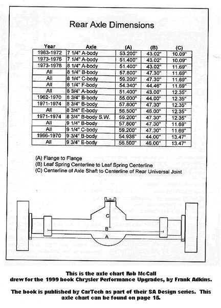

Try this link it should tell you everything you need to know. https://www.bigblockmopar.nl/tech/mopar-rearaxle-dimensions/
And once you know what size you need and find something at a swap meet that might be a quarter inch difference, don't worry about it because they're not always exactly by the book.....

That chart on the mymopar site needs to be burned. It's got so much incorrect info on it. Been around for years and screwed up MANY people.
Sticky in the axle section right here on this site.

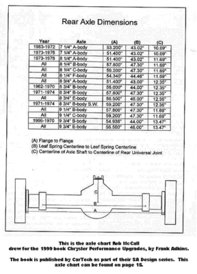

This too
That is the garbage POS chart... ugh...
K. Does someone have correct measurements? I'm looking at a rear end from a 71-72 Charger for my '71 RR (8 3/4). I want to make sure
