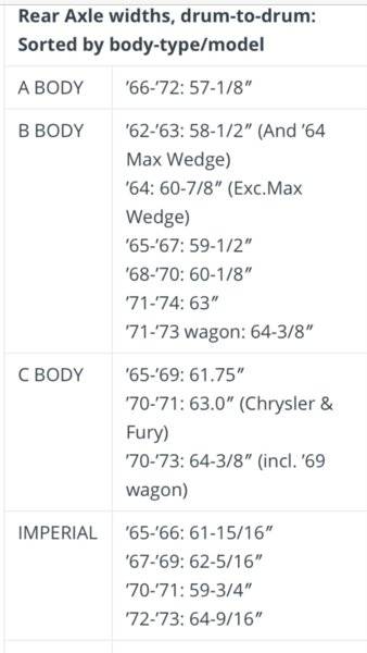

Have a 72 Charger need 8 3/4 rear end. I found one from a 67 Coronet. I know I will have to change spring perches but wanting to know if it would be to narrow?
Have this on my desktop.
