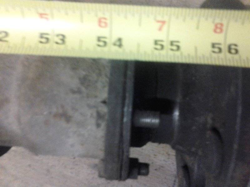

First pic is a 63 Polara rear at 53 5/16" flange to flange

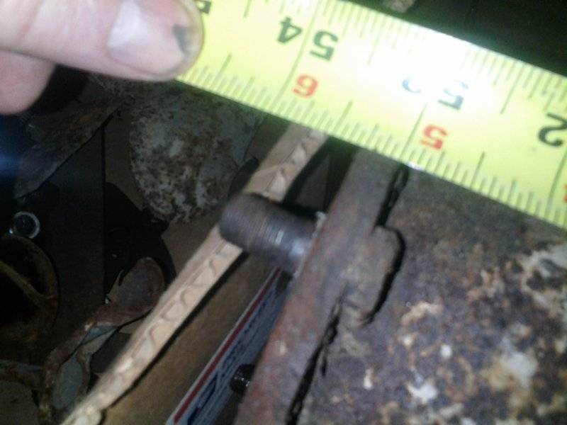

Second is a 65 Belvedere rear at 54 5/16" flange to flange.
Its only a 1/2" on each side...
Do whatever you want but there are good ways to get around using the old style axles these days...
