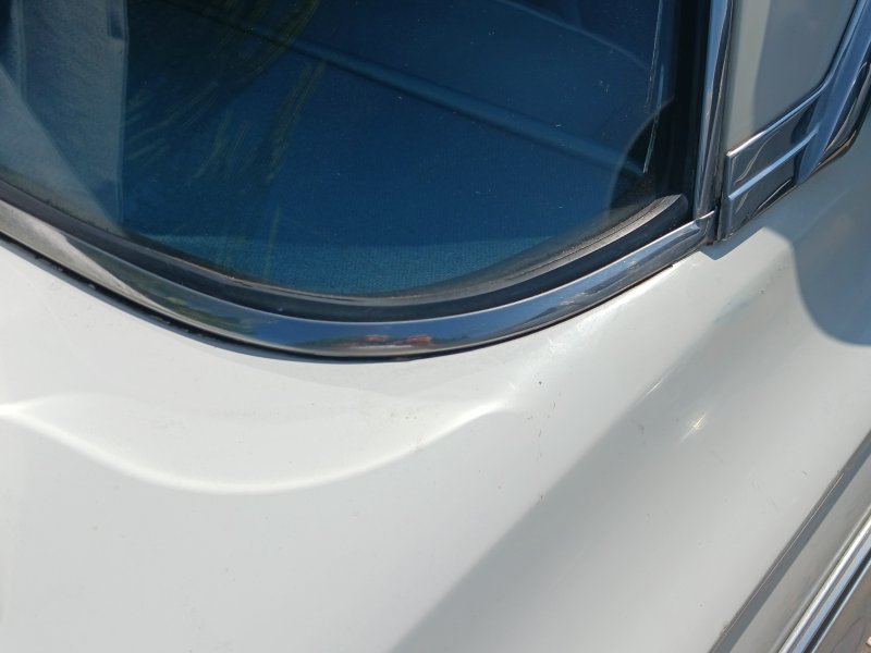

How does the exterior lower rear window come off?
65 belv2
see photo

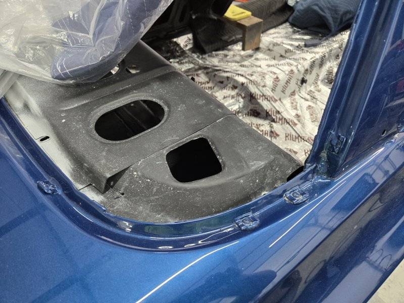

If it's anything like my 62 there are clips screwed into the body. The clips are in-between the seal/body. Cannot remove clips without removing window/seal.
I located the clips with a small pick, and using pressure on either side of each clip carefully popped the trim off.
can anyone confirm this is the same on a 65? Any pics of the clips on the car but with the window out so I can see whet I need to pull/push on?
Does anyone have a pic of this year with the molding off so I can see when id be working with?

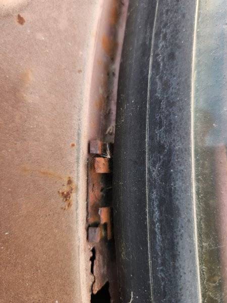

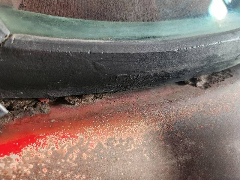

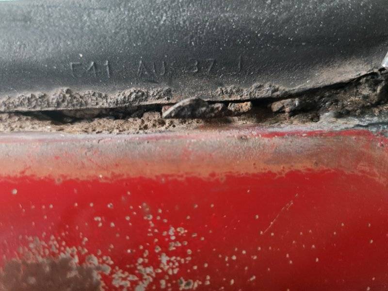

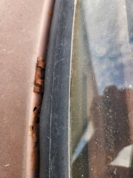

This is my 64 fury. Rear window. The red car pictures show part of a clip under the seal. They are all rusted off.
The pictures of the brown car is of the windshield. Clips are similar to the rear clips.
Hope that helps

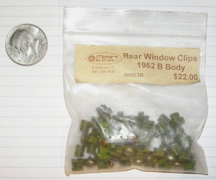

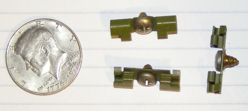

These are 62 rear window B body trim clips from Mopars by Crane (kaput in 2009) and definitely don't fit a 65 FWIW, 64 maybe, but they were not labeled/packaged that way for a reason I suspect.
