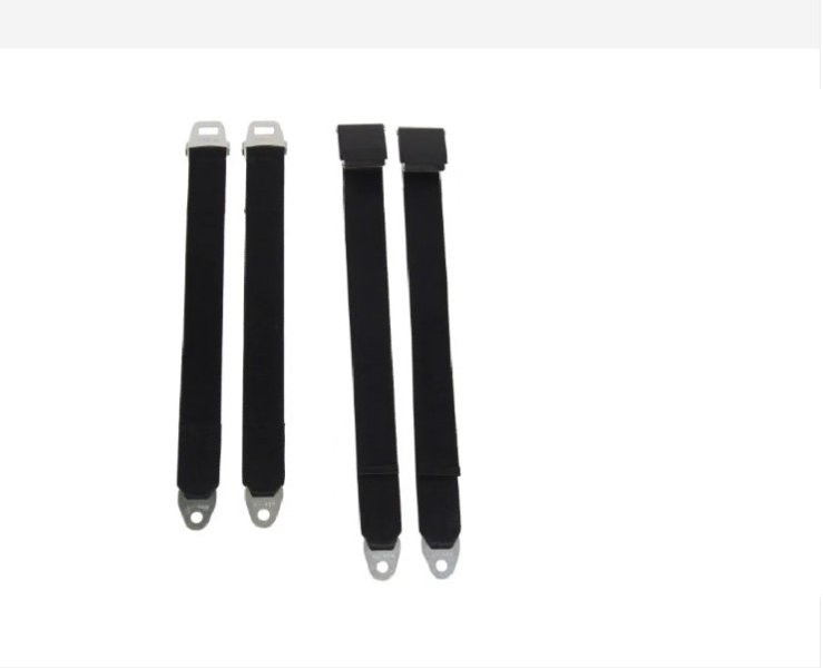

Does anyone know where I can find the individual Anchor Bolts for the rear seat lap belts .Vans sell them but the shipping to the U.k works out $50 for 2 Bolts and as I understand I need 3 Bolts for the belts as pictured ..Are there any alternative Bolts to use..Thanks Screenshot 2025-05-08 140718.jpg

That said, I would suspect a '68 (I assume from your profile pic), like a 69 or 70 use three sets of belts in the rear and you need Four bolts.

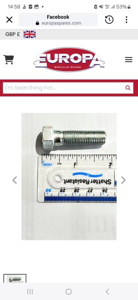

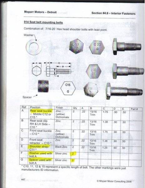

Does anyone know the length of the 7/16 bolts as I'm in the U.k and trying to see if I can find something here which could work
@Christian B, I live in New New Zealand. you will find its a standard bolt. especially in older cars
It's a standard SAE fine thread bolt, but has a special shank above the threads and a shorter than standard hex height.
