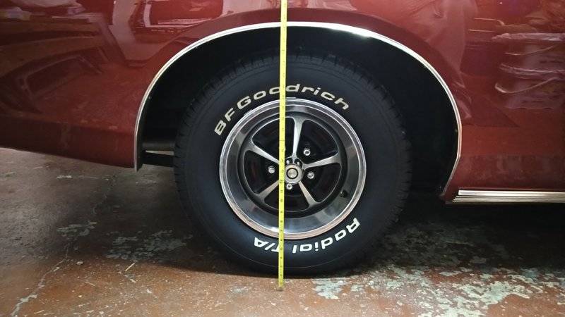

I thought all HD suspensions with more leafs on the one side had a slight height raise on that side?
....The Eaton’s on my X with the correct leaves for the HD suspension has the rear level....on my charger with the Espo’s with the same number and HD suspension is raised on the right a lot as your referring to......that’s why I dont use espo.....people fall in love with the price but IMHO you receive a lesser quality spring.....
Originally, it wasn’t noticeable but my charger it’s hideous.....
Sorry, just to be clear. You're saying that it is correct to have an extra leaf on the passenger side, but the rear should still be level? The espo springs have the same number of leafs on both sides, but the right is raised?
To be clear 6 DS 7 ps for the Hf suspension......Eaton springs sit the car level...at the time I put Espos on my charger the difference was and inch, no kidding...which questions the arch as well...originally, the height differences was minimal at best.....
You get what you pay for and everyone loves Espo because of price and you also get Chinese steel.....The picky ones like me that want quality and correctness choose what is best...
Thank you for clarifying. I always thought that correct was to have the PS sitting higher. I guess Eaton is the only one that has the Ps sitting higher with the correct number of leaf springs.
