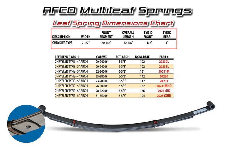

Anyone used the Afco xhd springs? 194 rate 5” height? They sound real good in the ad using the chrome Vadium steel(hope I got close on that). I’ve got 440hp 4 speed I ran the Mopar one with six leaf on one side and seven on the other. They came from Mexico and they didn’t hold up real great. Thanks in advance.

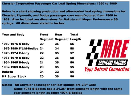

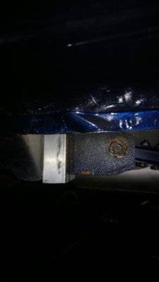

To use the Afco springs you will have to do what I did with the Hyperco leafs and make a bracket spacer or you can by the Mopar superstock front bracket and then weld the hole closed and drill a new hole 1half inch off center of the welded hole center. If you look at the 2 charts below you will see why. For whatever reason the circle track springs have a 20 1/2 front section. Nobody makes a bracket for these to keep you rear end centered. What I ended up doing was going on ebay and buying a 1.5"x3" 10inch long piece of 6061 aluminum billet $25, cutting it in 2, 5" sections, pressing out the factor bracket studs, expanding the holes to 7/16 from 3/8, marking and drilling the holes in the billet spacer than bolting it all back together with grade 8 7/16 hardware and washers. See picture below.

Thanks for that info. Those are very different deminsions. Glad you brought that to my attention. I’ve got to have bolt in. Thanks again.
Glad to help. I spent weeks researching springs before I went the direction I went so the info was fresh on my brain.
