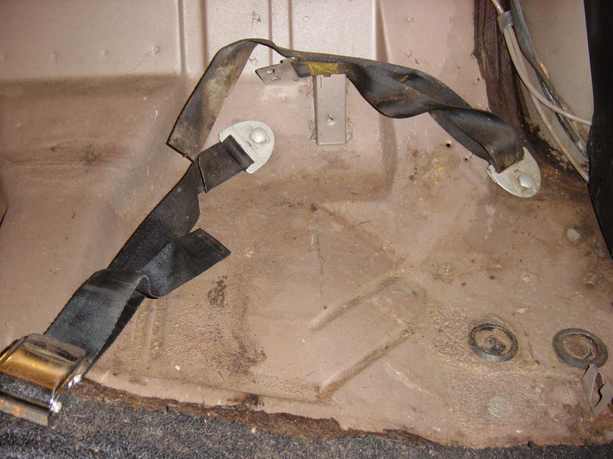

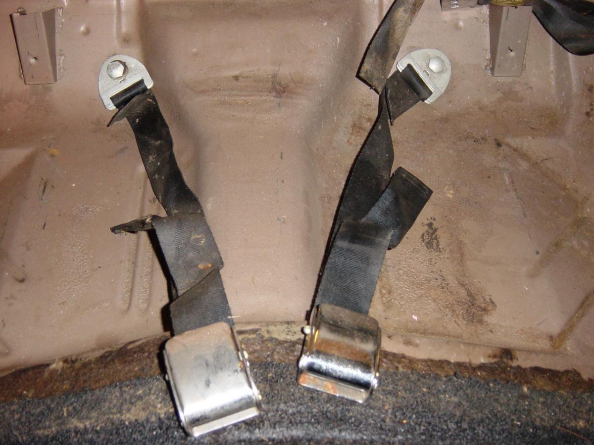

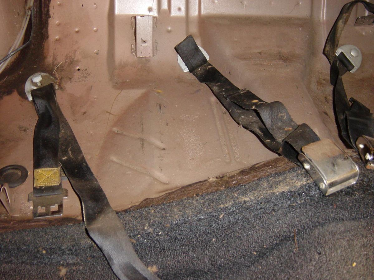

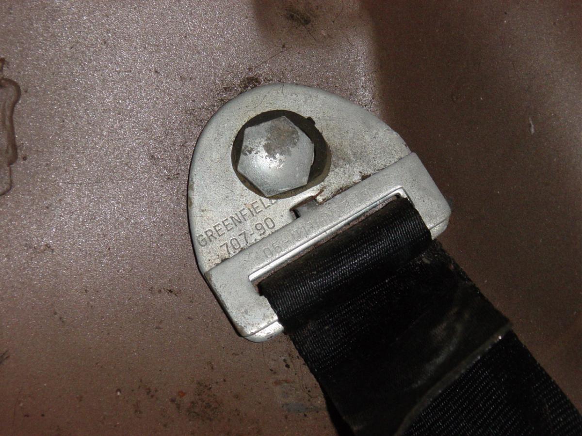

Here is how Plymouth was installing the rear belts in the 65 Belvedere II convertibles. You can see the hardware and the manufacturer name. Hope the pictures help.
Thanks alot for the pics.

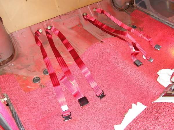

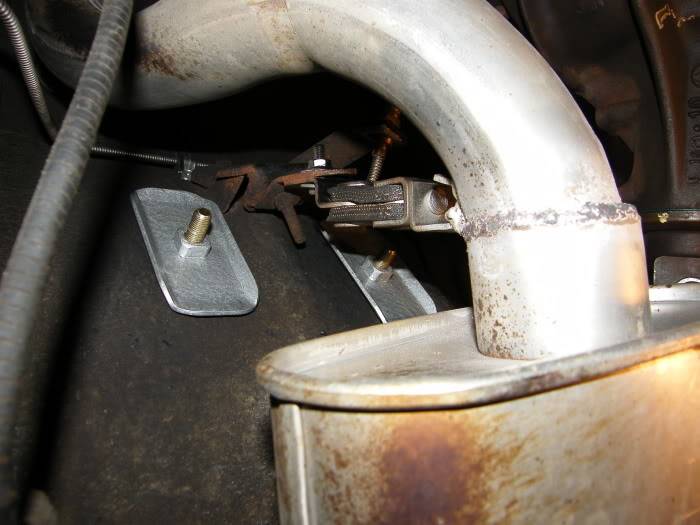

We fitted some lap belts (from Juliano's) in the front & rear of our 63 Polara.
Front already had belts so we used the same holes for the new belts but we had to decide where to mount the rears....
Viewed from underneath
Thanks again for posting some pics. I installed the belts today, I really hated to drill 4 holes in a good pristine floor, but the little hooligans gotta be safe in their car seats, plus the better half would have fround upon not having them in.
