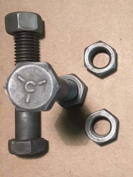

Believe these are the original upper shock bolts on my 69RR. 1/2-13 x 2.75…….I’ve also seen the hex heads marked with an M with 3-hash marks…jim
