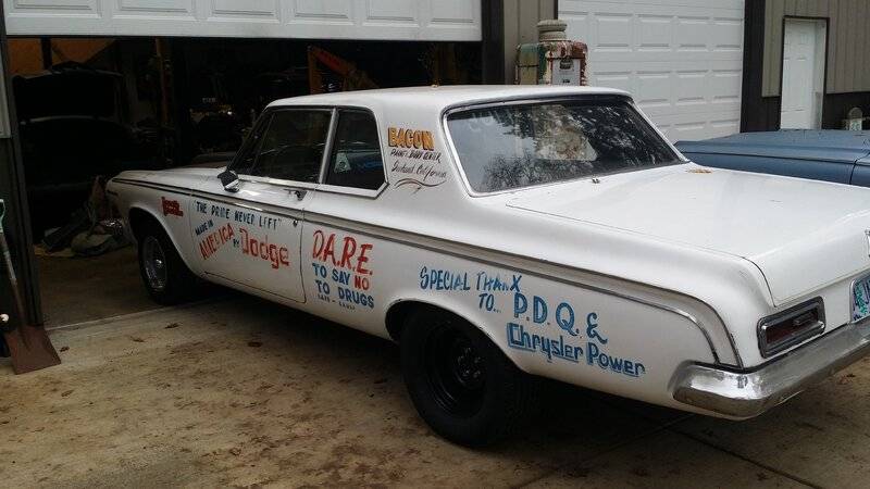

What is the extended length of the rear shocks on a 1963 dodge? I want to raise the *** end of mine and replace the air shocks with proper extended length shocks after I have my rear springs re-arced.
I have QA1 rear shocks for my 65. extended length is 23.870".
What rear springs are you using? I'm looking at eaton springs 3inch higher than stock that would help me with the tire size I'm currently running.
