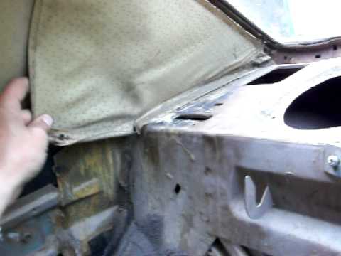

Here is a pic of the slot for the ones that were equipped from the factory, dont know if the retractor is available though...
From within the trunk I can see that slot, so I imagine adding shoulder straps would need the straps themselves, a different buckle to clip into and for some adjustments to be made to the mount points and the parcel shelf. I wonder if any old generic retractable belts might bolt into the trunk and the other elements mounted to the existing mount points under the bench for a more modern, child seat friendly approach...
