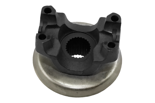

The pinion yoke has a small tab on each side to prevent the caps from moving out. No clips go in the pinion yoke side, only the driveshaft side.

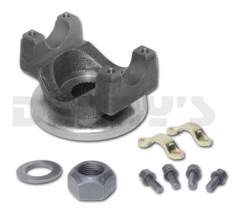

the yoke in the picture is a dana style yoke with u-bolt straps the standard yoke on 8 3/4 does not have the little tabs and requires the clips on the cap to keep it from walking out.
He said that the straps cover the grooves where the clips would go, but the grooves are not for the clips. He also never mentioned which axle he has, so we can really only guess which he might have. I have had axles that used the clips, but they rested against the strap mounts, and are not covered up by the straps.
As I said, he the grooves were covered, and as you can see in the picture, there are no grooves. On way or another, either the tab type pinion is missing tabs, or the clip type pinion is damaged to where the clips won't fit in between the strap ears, and a file can fix that. A roller can fall over and prevent the cup from fully seating, but that usually happens when the cap is knocked in and a roller falls into the bottom. It is not usual for a roller to become misplaced on the pinion caps because they just rest against the pinion yoke. The last thing I will mention is that someone could have replaced the original yoke, and could be of a different style.
I disagree. I have a 71 rr with an 8 3/4 rear and it has the tabs like in the picture. To my knowledge, it is original.
I have seen them with and without the little tabs on the yoke. I always put the clips on the caps, even if the tabs are there. I also like to use new straps as they can stretch after a while.
if his had the tabs on the yoke it would NOT have fallen out ...........
No tabs on the yoke! 8.75 rear end, 741 case. Thanks guys, I'll try to see if maybe i can get those clips on there properly.
