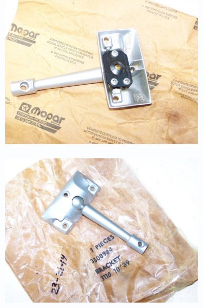

The post of my rearview mirror is loose. See example below. Is there supposed to be an insert under the black plate that holds the ball on the post snug? Right now there us what appears to be wadded up paper in there, which obviously isn’t working.
Any tips or tricks appreciated. The loose mirror is getting old.
Oldest trick I have,
Unscrew the plate, hammer the concave hole flatter, reinstall.
You minght not be able to screw the 3 attaching screws all the way after if you overdo it.
Agree with above. ^^ Add a little grease while in there as well.
Will do. So simple a fix, I couldn’t see it. Thank you!
Just don’t go over board on the hammering, little increments. Did this recently myself
I have also place a thin piece of cloth in between to tighten it up.
All good suggestions. Gonna tinker with it and report back. So far placed a thin piece of cardboard between plate and ball. Holding well. Wanted to try that before “love tapping” the plate fir tighter fit.
