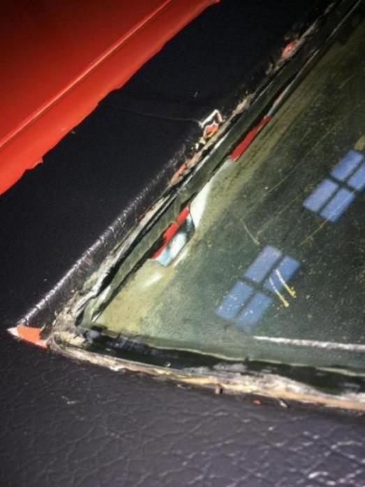

I am trying to put the rear window trim on, and the new clips from R/T specialities keep popping off the trim studs. Can ANYONE help?
I think I found the problem. The people who put in the rear glass didn't use a ribbon, making the glass sit too high. Sucks when you pay someone to do something and its not done right. Looking forward to when I can just enjoy the car and drive it...
I had the same problem with the new-made clips. I was fortunate enough to live near a junkyard that had a couple 71-74 Bs sitting in it and I took the clips from those.
The old clips from other cars worked fine, but the new clips didn't, so I suspect the problem is more of how the clips are made than how the glass is installed.
