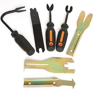

The tool I use is the metal one on the bottom
You totally bummed me out with your pic of the trim removal tools!!!!!!!!!!!
I have been searching threads to find out "how to" remove trim. I was wondering if it could be done without special tools. I guess not.
rrrrrrrrrrrrrrrrrrr, thanks for the pic!!
does not matter if I get temporarily bummed, it is better to know before I start than after I have destroyed the trim
again - thanks for the pic
Not sure why your bummed it is a single tool...the one in the bottom of that picture but you typically have to buy it as a kit.........It is a very cheap tool.....

I totally agree, get the tool. Was bummed it required a special tool. I have never removed trim and had absolutely no clue how to do it. When I saw your pic - instantly knew I didn't have what I needed to get the job done. So glad you posted the pic. When I saw ALL them specialty tools - You was able to tell me lots. Very much appreciate your pic - it told me lots.
That tool is a lifesaver......
