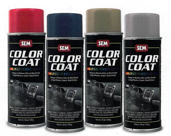

I used this on the cloth B body Charger.
It says it actually and "elastomeric coating".
Blue over blue.
On the cardboard A bodies I got whatever "dye" was on the shelf at Pep Boys.
I think it is Duplicolor.
I'll check my left over and correct that if necessary.
I used this for black over dark green.
And tan over tan.
+1 on SEM brand products. I have ised them for light blue over navy and black over blue. I found several light coats were the key to good outcomes.
