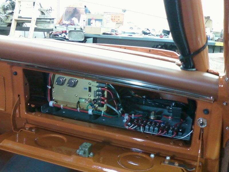

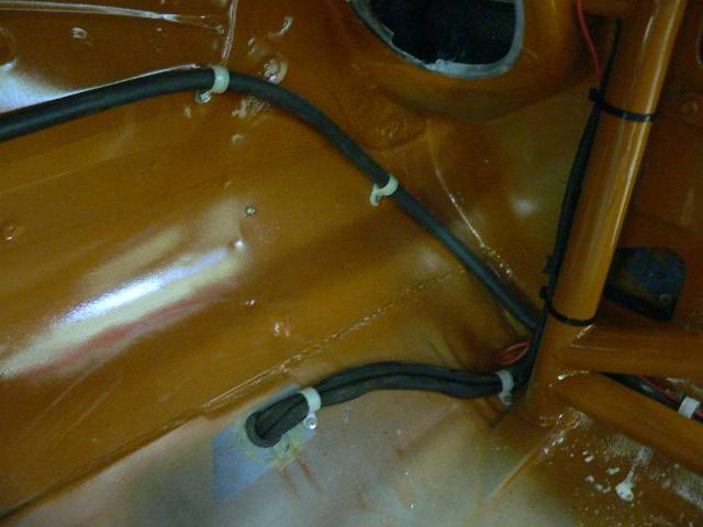

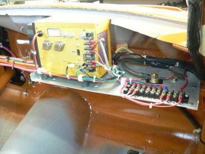

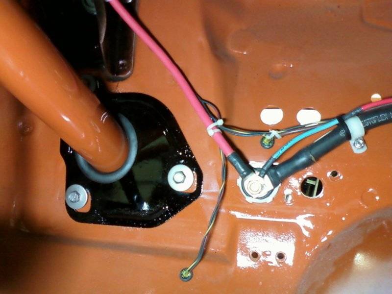

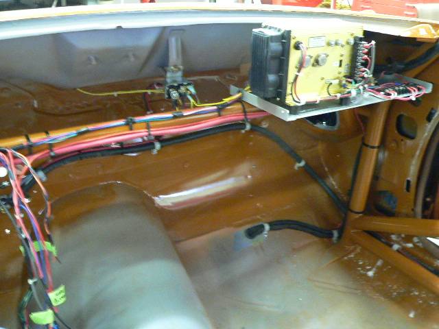

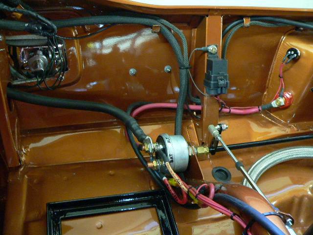

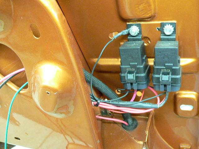

I made my own. Not that tough. And WAY cheaper. A few shots. All forward wiring goes thru he RF frame rail to hide it.
Doug

Put anything that draws serious amps on relays, headlight,fans, fuel pump, water pump, heater fan, etc.
