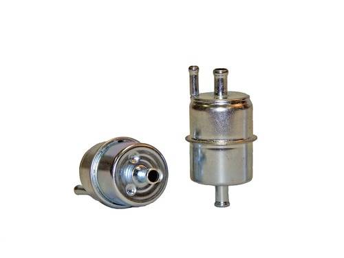

Plenty folks have successfully added return lines with mechanical fuel pumps - in fact Chrysler did.
You don't need to use a regulator, just one of these fuel filters will do - the 1/4" barb has an inbuilt restrictor - (Wix 33040 for 5/16" lines or Wix 33041 for 3/8" lines). Install with 1/4" barb at 12 o'clock position (as bubbles float) and say goodbye to vapor lock!
Thanks I’ll try one. Guess I need a new fuel sender with return too?
