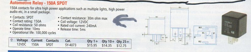

I use this relay, compact & cheap. Contacts have a 150 amp rating. Since you are switching solenoid current of 60 amps at best, the 150 amp rating should ensure long contact life.

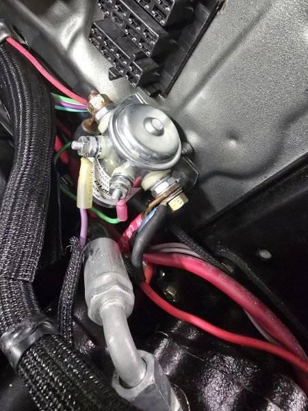

I always thought if you jump the solenoid, meaning 12+ to the signal wire and it works, then the problem isn’t your solenoid anyway since you are just doing what the key switch does. @Timmayy is that what you did or you jumped 12+ to the fat wire to the starter?
By bridging the terminals, you are bypassing the internal function of the relay. It means that the relay isn't working correctly.
