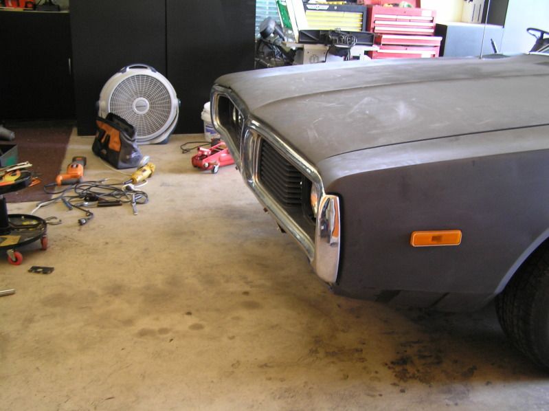

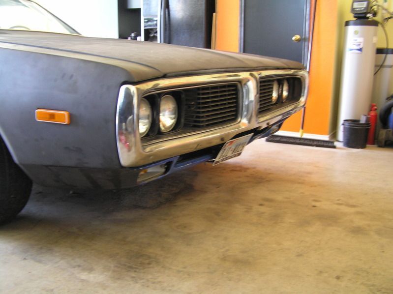

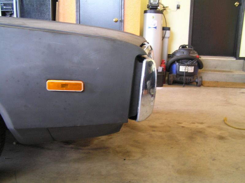

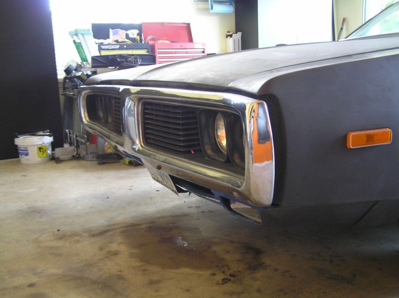

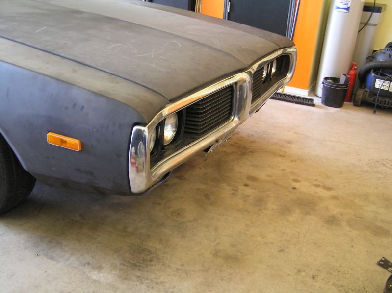

Well I got tired of saying I was going to do it and got tired of looking at that awful gap between bumper and fenders/hood. It pretty much took me the better part of yesterday to complete and I will have to pull it off to do a little tweaking here and there but nothing major.
Before
After
Looks great in my opinion I'm gonna do that to all mine
That looks awesome, dude. Give up a little info on what you had to do to get her to go back.
Came out awesome! That looks killer, you just section the backets orr?

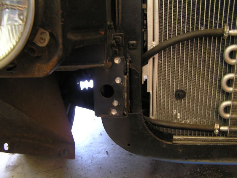

you enlarge the holes in the brackets, i have a small drill press so it worked out great, then I joined the holes with my angle grinder. You also have to modify the front of the frame rail or the bumper will not go all the way back but that's not a big deal.
Here's a picture of the front of the frame rail, I drilled out the spot welds, then peeled it back so I can see here I needed to cut it off, I will box it in later when I take the bumper back off to do my little tweaks.

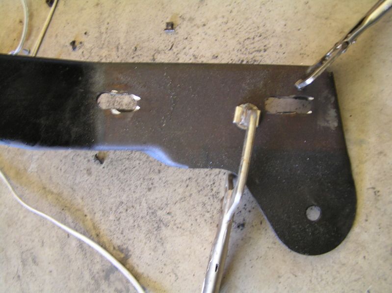

Here is a picture of the bumper brakets, it shows where I drilled them out then took the angle grinder to join the holes.
