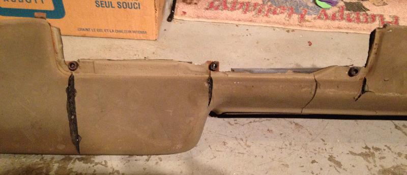

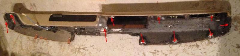

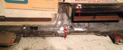

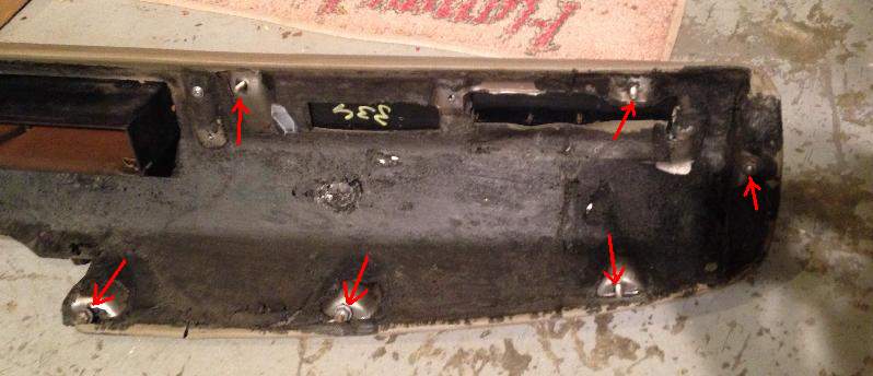

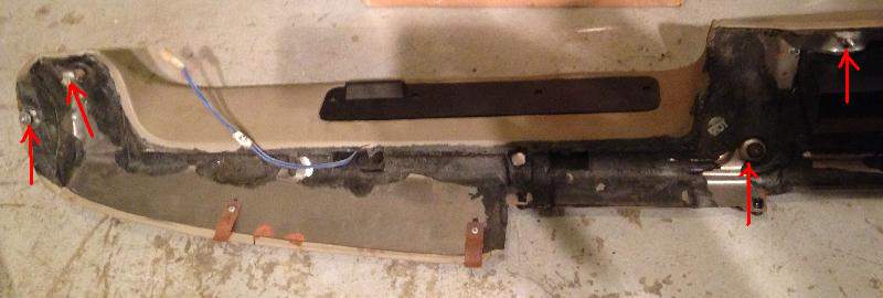

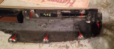

Pictures would be excellent if that would be ok ,it would save a lot of time and guesswork,thanks.
Here you are, I hope this helps;
Satellite74,
IMO you really should take a few photo's as you are removing it. It will make things very smooth when you are putting the dash back in if there is an area where you unsure of.
