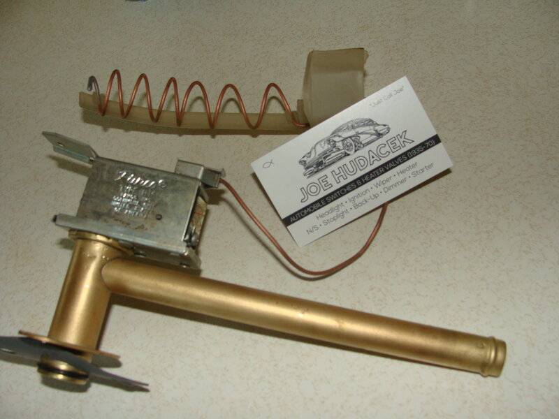

I would check the heater valve first and see if that is your leak. It is on the left end and can be replaced without removing the heater box.
Agree - was going to say same as I had this issue in my '63 Plymouth. There's an O-ring that gave me fits after rebuilding the valve. The leak was outside the box.
