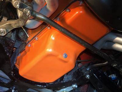

I want to replace the oil pan gasket on my ‘68 383 Super Bee. Is there enough room to lower the pan, remove the old gasket and install a new one without having to drop the steering linkage?
(Photo not mine but similar)
Thanks!
Bob
Pull the bolt out that mounts the idler arm & it'll give you enough room to get the pan out..... Though honestly it's easier if you also pop the passenger side tierod loose...

Dropping the link would most likely be best for you.
Good luck getting the gasket around the oil pump pickup….
You need to pull the pan out. To do that, the idler and pitman connections to the center link should come off.
Not sure what the concern is. It is extremely easy to pop one side and swing it out. No adjustments necessary to reinstall. And makes the job very simple. It adds 10 minutes to the job. Spend more time posting on the site.
It also may help to rotate the engine to TDC area on #1 so the front crank throw is up and not down.
