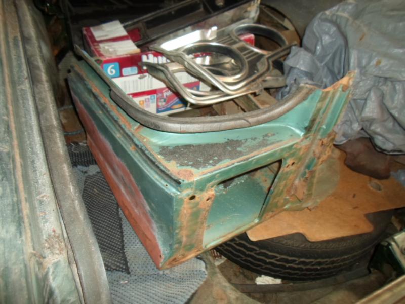

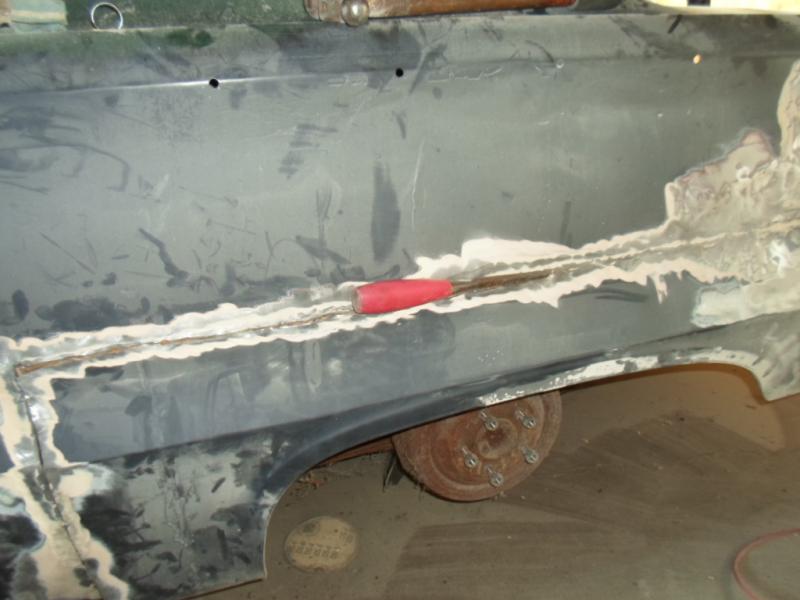

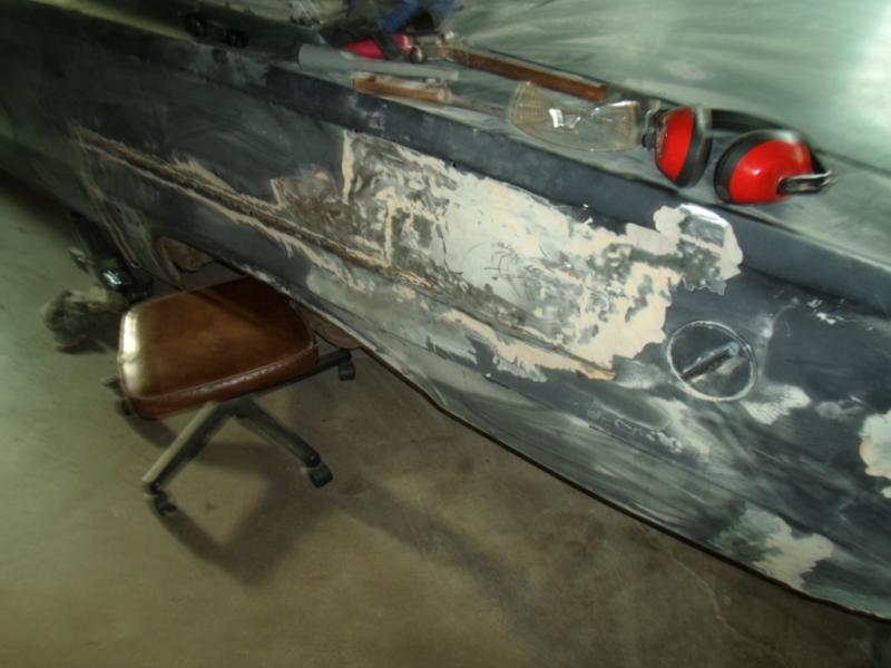

Well I tried the heat gun for awhile but was worried about doing where the rear door panel is,I didn,t want a fire.The metal gets pretty hot,so I tried one of those black scot bright looking pads on a grinder that I didn't know what it was for and had sitting around,and it worked like crazy but now my clean garage is a mess and I didn't realize how many spider webs I had.I got most of the panel off but is stuck somewhere along the wheelwell,probably a plug weld or a screw.I did grind thru the original metal a bit so I took and old wood chisel and it followed the weak part of the weld where it was ground smooth and it just followed the path of least resistance.I'm not worried about the taillight section as I got a new one from a board member last year.

Hey your getting there! At least its cooled off enough now to get working on the projects. I hope your wearing a dust mask or something while your grinding. That bondo dust will kill you! Have fun and we all look forward to seeing more pics!
Wearing the whole get-up ear muffs ,mask and glasses and a fan to blow the dust outside.Looks like I salvaged the old sheet metal and the new panel,at least I can use it to fix the rusted wheel well lip.
