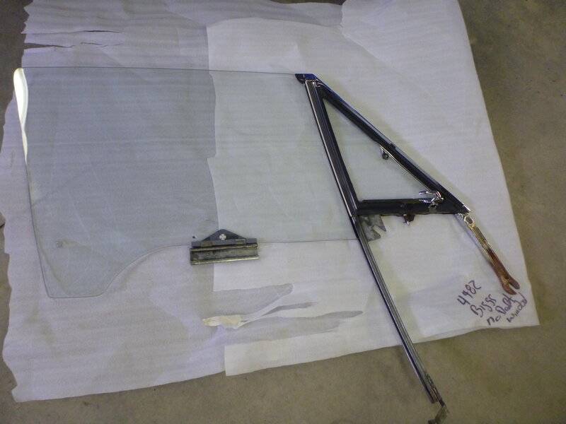

Must be an easy way, 67 Coronet, what is the procedure to remove the door glass and vent window assembly. The glass slides in the vent window drop down channel, it seems secure cant just dislodge it from the channel. The rubber corner piece on top of the vent prevents you from sliding the glass straight up. Whats the secrets?
Dan
Take the screw out of the rubber block (unless '67 is different than '68/69/70) but I highly suggest that you remove the entire assembly as an assembly, then put it all together to put back in as an assembly.
Thats the way I ended up doing it , I just couldn't believe that was correct
They are a PIA for sure. I also have removed the upper trim piece so I could slide the glass up and out of the A-Frame (on a '68).
