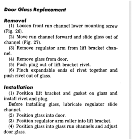

Working on a 69 roadrunner door and am stripping down an old door. I don't have a manual for these particular years and it doesn't look like it's the same as my 66 Belvedere sedan which is easy. Any help doing this would be appreciated....

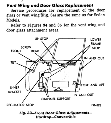

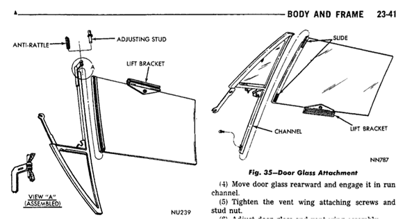

The difficult area is removing the plastic pin from the lower frame stop. Once the glass is rolled down to expose it. I spray a silicone based product on it. Then I wedge blocks of wood behind it tightly and take a center punch and pop the plastic pin out....
There is also an up stop on the rear of the glass that has to be removed.
The one area most people forget is the Allen head bolt with square bracket. This is accessible through the small hole with the colored plug. That holds tension in the rear arm of the vent window.
The last thing is to remove the captive nut with washer through one of the larger black or colored plugs to the far right on the upper painted pad.
Then pull it out as one unit...you will have to angle towards the rear a bit...
Whoops.....yeah, forgot the up-stop
Also, I think there's one small screw, in the door jamb, right at the very bottom of the front part of the vent window frame... it holds the front edge of the door seal.

That’s why you leave the rubber up stop on the vent frame. Once everything is loose. Pull the door glass to the top. Hold that with one hand and with the other hand grab the vent window. Then pull it out...easily done with one person but if you have a second person helps. Sometimes the second person is not helpful if they are not understanding you....goes in the same way in reverse.....
Also just to note, you mentioned this but remove the lower vent frame stabilizer. Remove the large plug under the door frame and remove the nut. Push the rod up and through the flat bracket and the wiggle it out....
Also....when you reinstall it as one unit put the door fuzzies in after......makes life very easy
