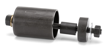

I hear ya Al. I have the American Muscle torsion Bar removal tool, upper ball joint socket and control arm bushing removal tool. All work great. Last year I was able to press out the upper control arm bushings in my Coronet with the tool, but with no avail, I couldn't for the life of me get them out with the tool on my roadrunner. Lowers I just tac weld a washer to the lip on the bushing and use the press at work to pop them out.
Here's the tool for the bushings:
Here's where I bought my kit.... I would recommend changing the bolts in the torsion bar removal tool with Grade 8's
http://americanmuscle.carshopinc.com/product_info.php/products_id/96913/22000BE
I think that their stuff is what Mancini's sells-good stuff. I had to get a tack weld on my bushings to get 'em out,but the tools did their job.
