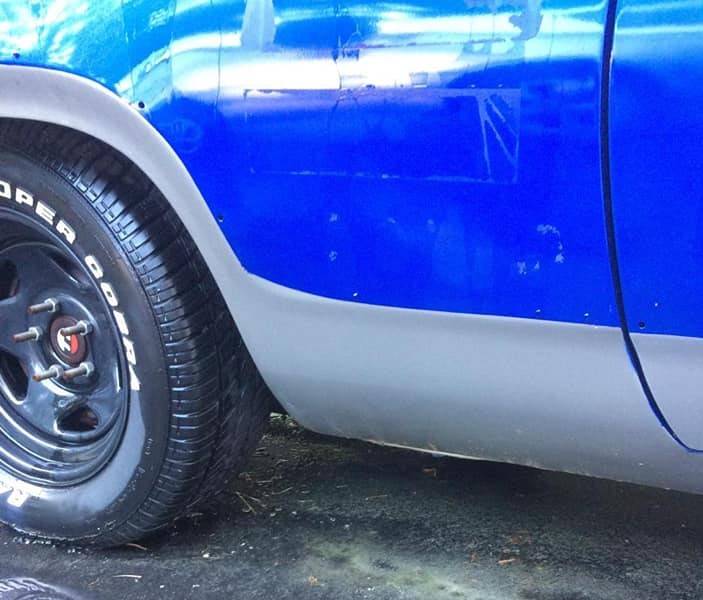

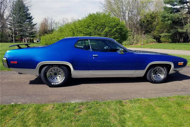

I'm very close to purchasing a blue 72 Satellite that has the Argent Silver lower with the molding removed so it has a bunch of holes along the sides where the rivets were. Does anyone know of a good shop or place that can weld the holes and repaint the Argent Silver portion to body color? I don't intend for it to be a show car, but I obviously want the blue to match up well and I don't want to break the bank. I'm around the NYC area. I'm also trying to get an idea of how much a job like this would cost since I'm not looking to repaint the whole car. I can't tell if it's True Blue, Evening Blue, or something else, but the pic I posted is the exact color combination. Thanks guys
That does not look like a factory 1972 blue to me, unless it's B7.

Those marks on the paint in the pic is just sticker residue. It also shows some of the molding holes that need to be welded
That's going to be a tough to blend that. Also, welding up those holes after it's been painted ; your going to get burn marks from the welder that will damage the adjacent paint causing an even bigger job. One of two things you can do is either redo and raise up the level of the argent or put the chrome trim on. I think the latter would be the best solution.
Honestly, I think I'd rather just keep it with the holes exposed over putting the moldings back on. No offense to anyone who has moldings, but they completely ruin the appearance of the car for me personally. Do you think a proper blend can't be achieved with that color or is it just a matter of keeping the cost down? If it's the ladder, how much do you think a job like that would cost to do it right and fill the holes along with repainting the Argent sections body color? $2,000? Maybe $3,000?

Does it look like there's any filler around the holes? That means extra time to remove enough around them to get good exposure of the metal to weld to and limit the burning potential.

I'm not sure if there's any filler there, I don't think so though. The pic I posted is one of the only ones where you can clearly see the holes, the rest are too far away, so my guess is as good as yours. The seller didn't believe there was any previous body work.

Good idea. I kind of stated a solution similar to this. Also, after the JB Weld is dried and smoothed out, the stripe is a good idea. However, another approach is to respray the argent, but bring up the argent higher to cover up the level that the holes are along the body.
IIRC the separation is right on the body line.
