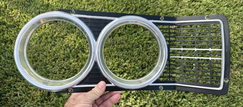

It seems like more of a satin black than gloss to me.
both your headlight bezel picture and my 66 coronet convertibles grill.
My man…
This is why forums like this are great. I was looking at it and it seemed right and at the same time it seemed a little off, but I couldn’t put my finger on it.
You’re right, it’s satin.

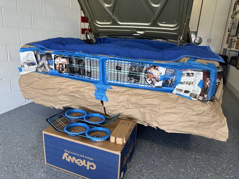

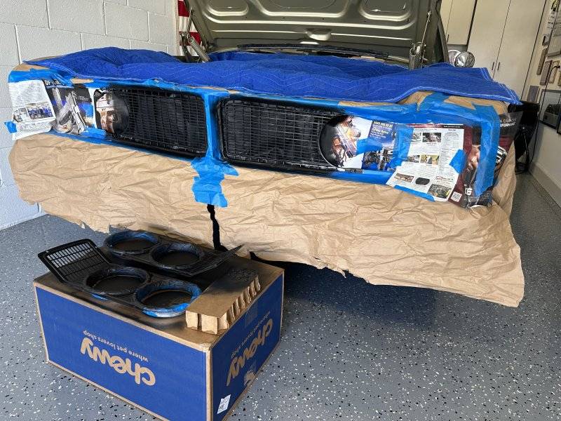

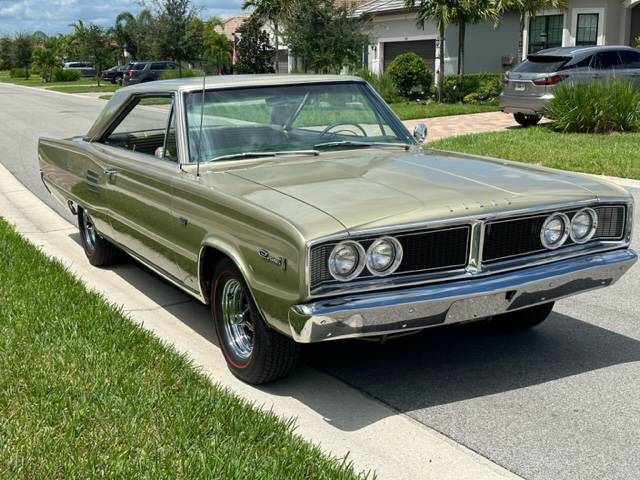

Update on progress.
Horrible looking tape job after stripping paint off parts of the grill that are supposed to be exposed on a 500. Shot the inside of turn signals with reflective silver. Then shot the front with trim black, and the end result. Not a big job or a big deal but it now looks like a 500 is supposed to. Much better for my brain.
