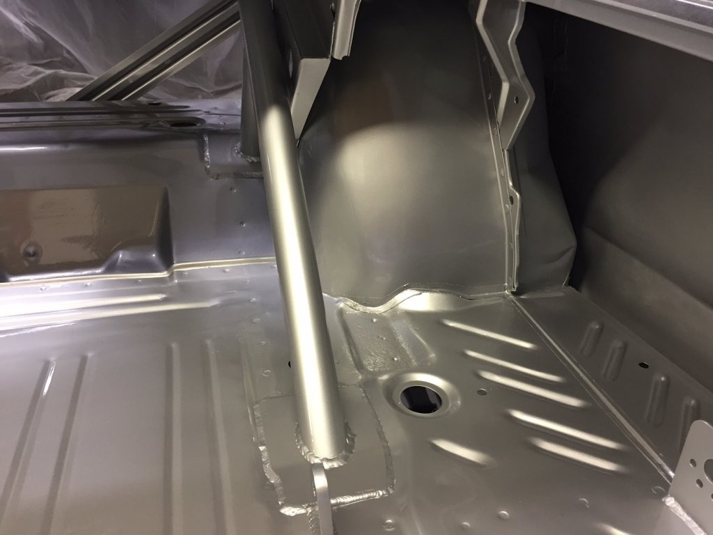

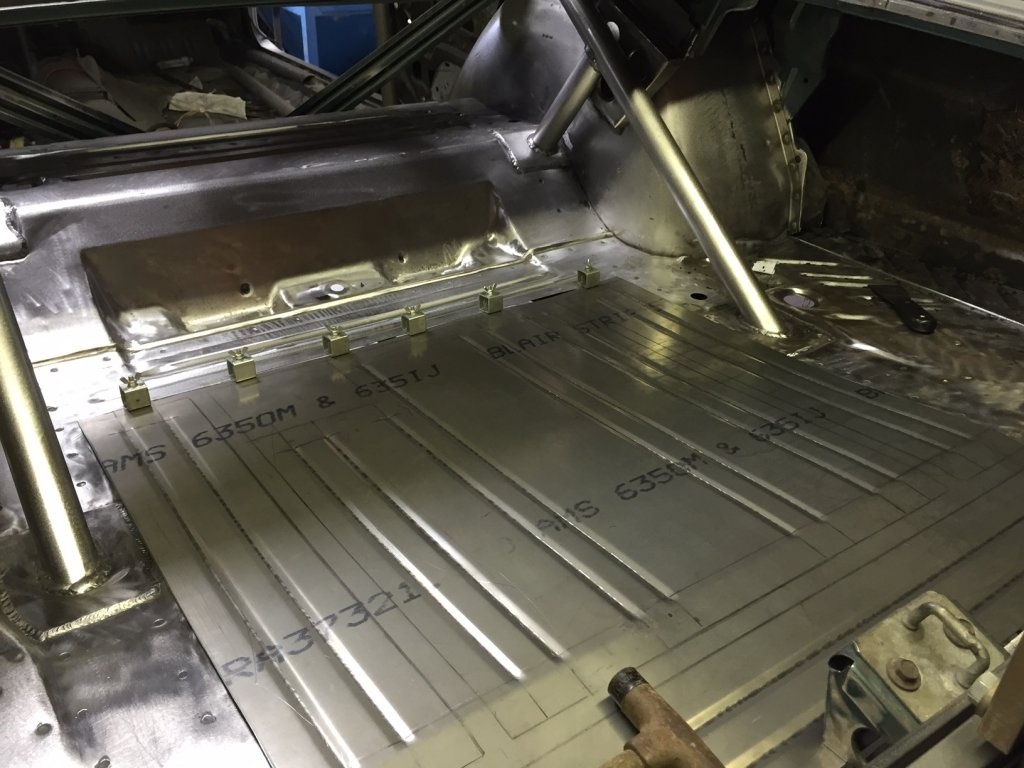

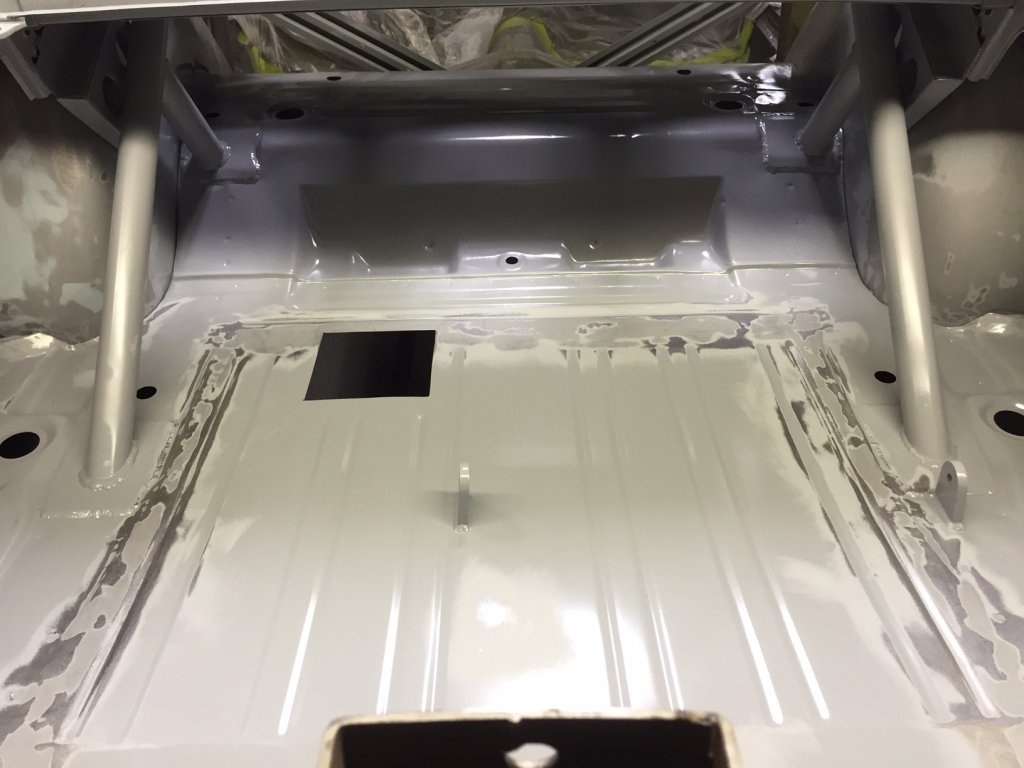

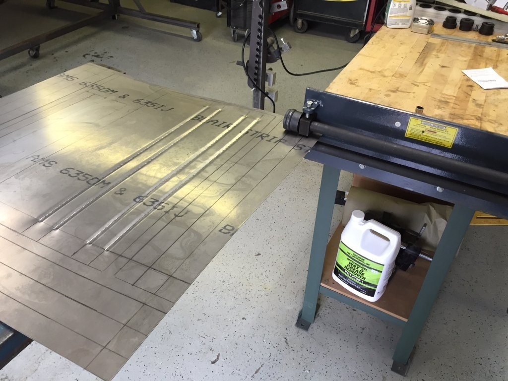

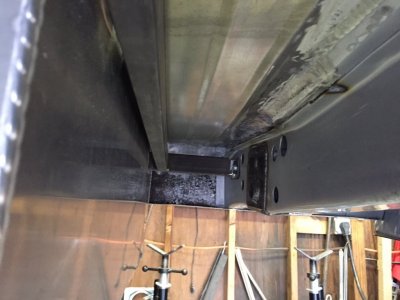

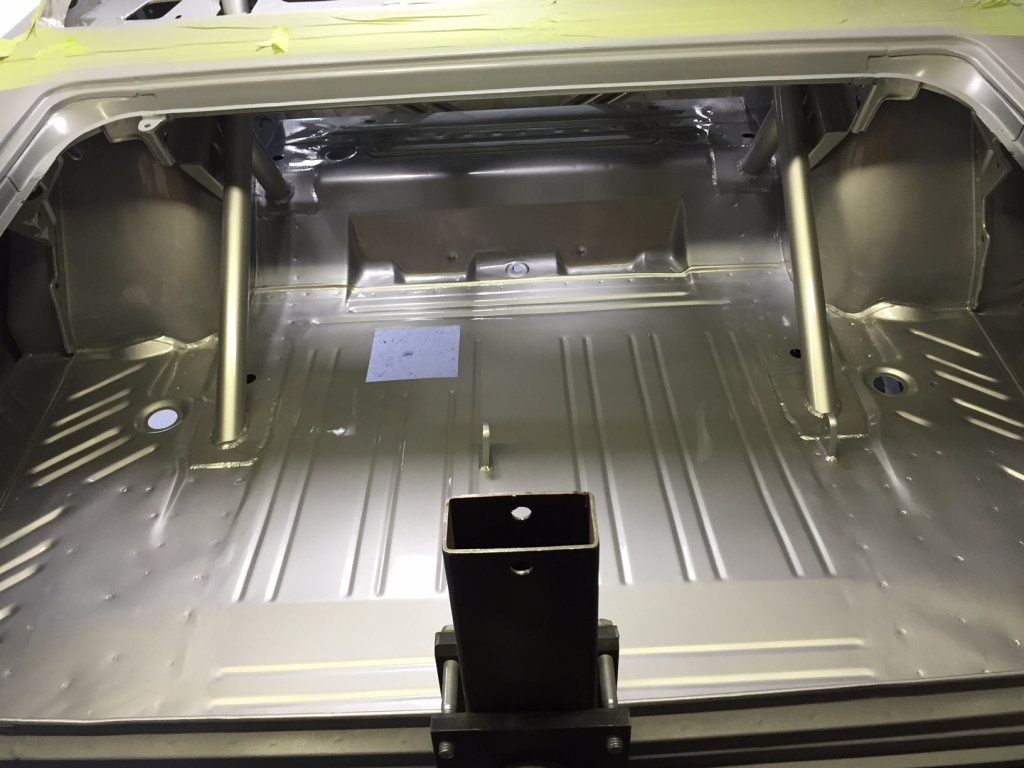

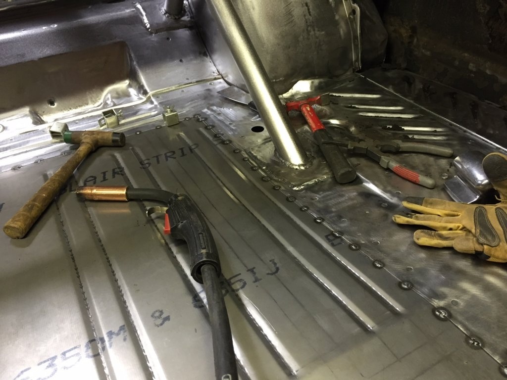

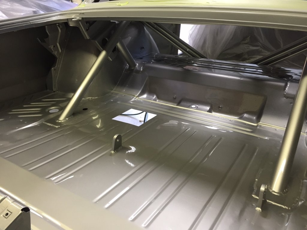

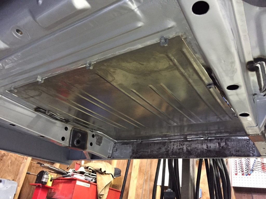

What I did on my Mini tubed 66 Satellite. Made my own .40 sheet metal and a bead roller.

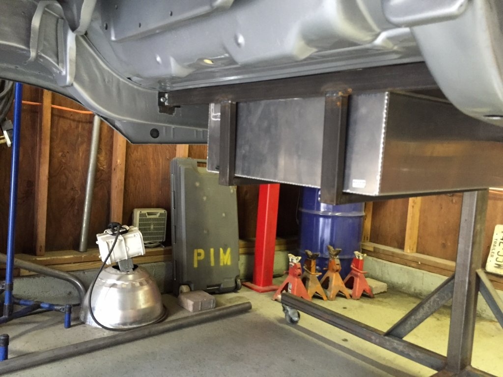

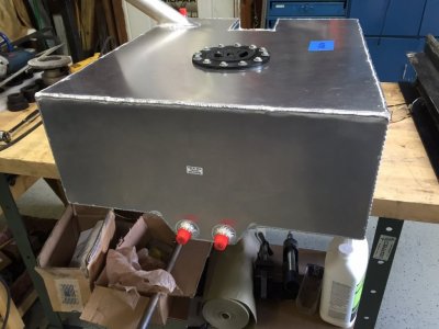

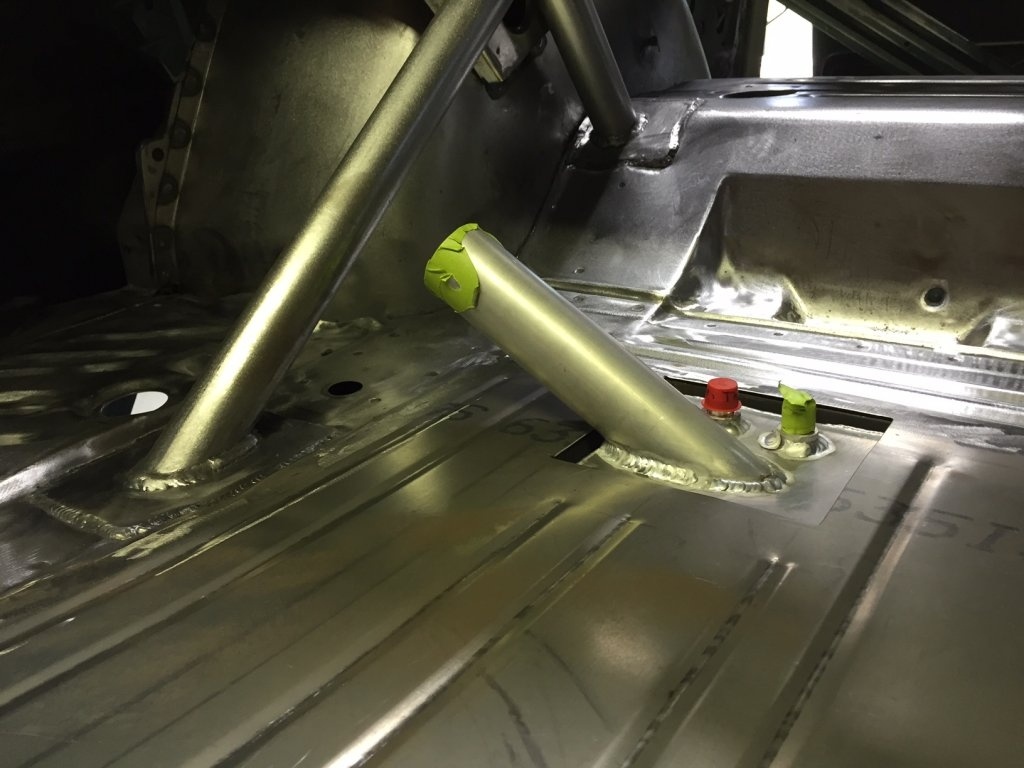

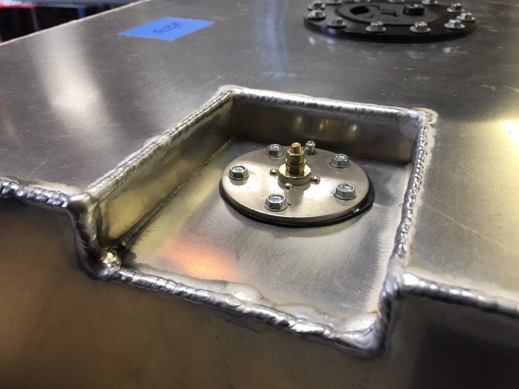

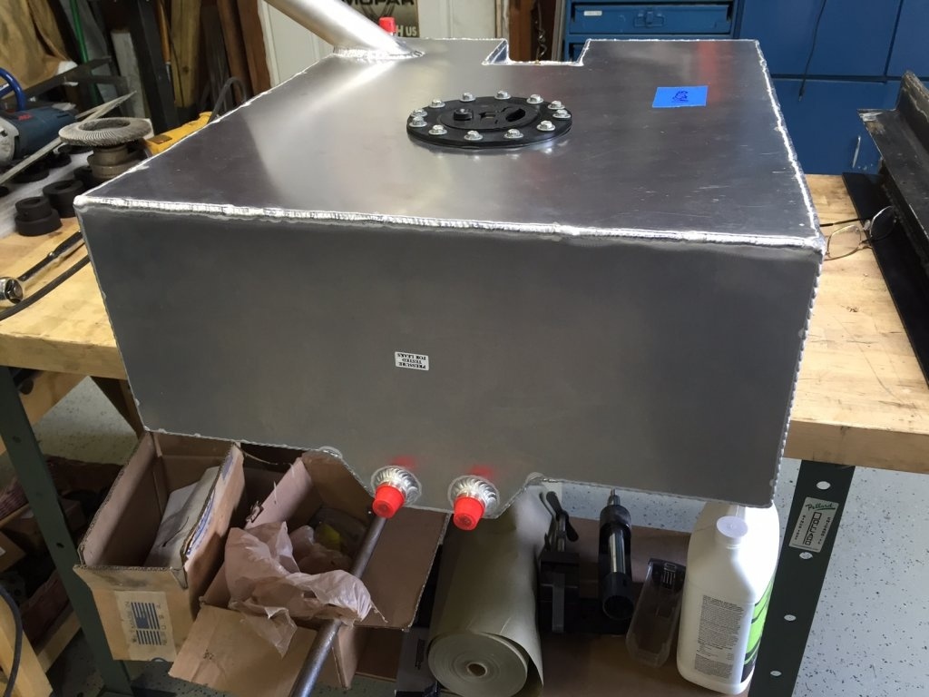

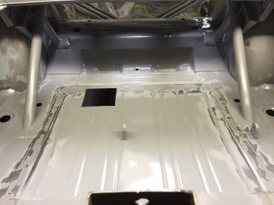

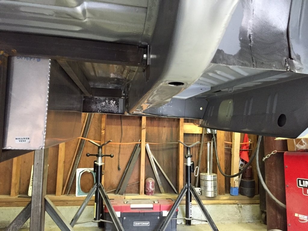

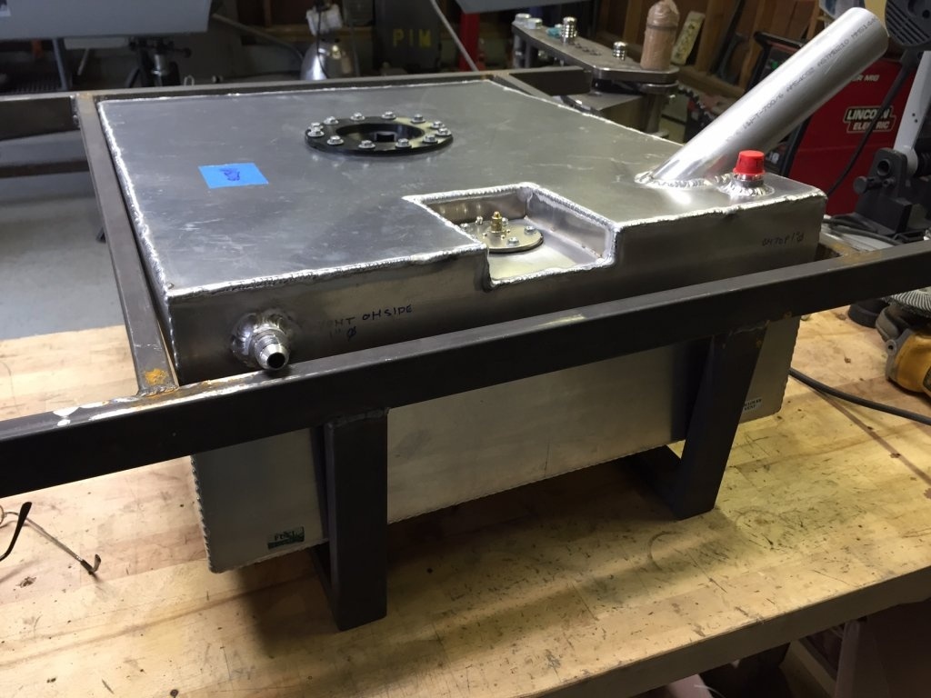

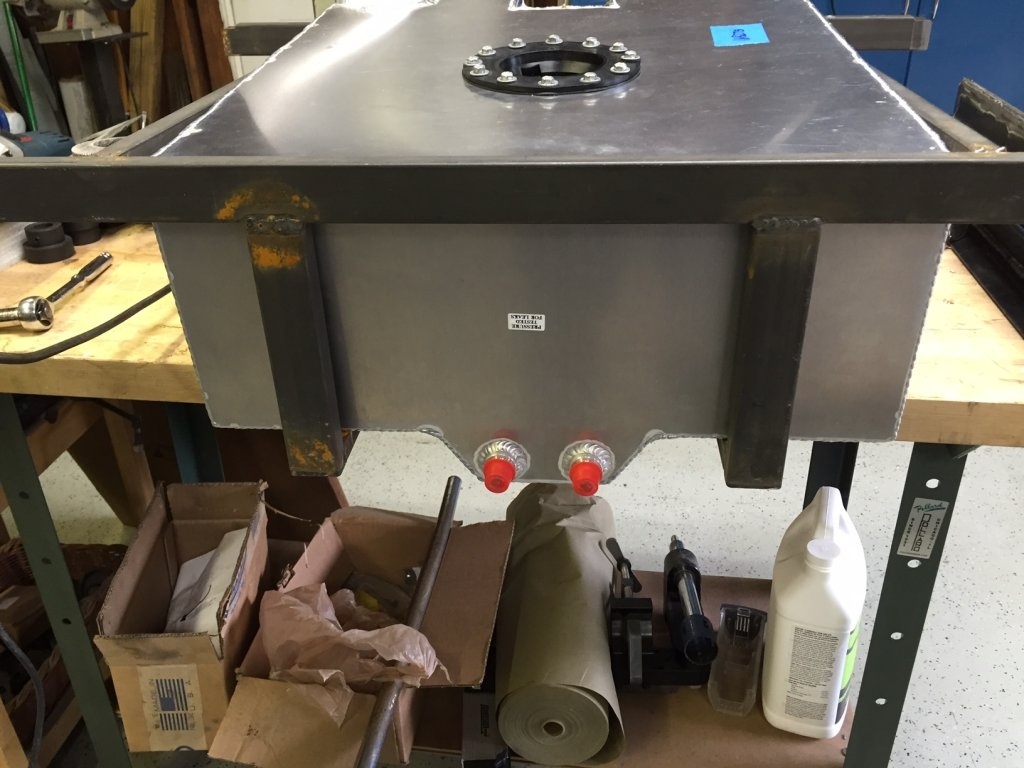

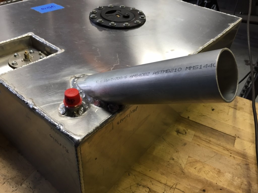

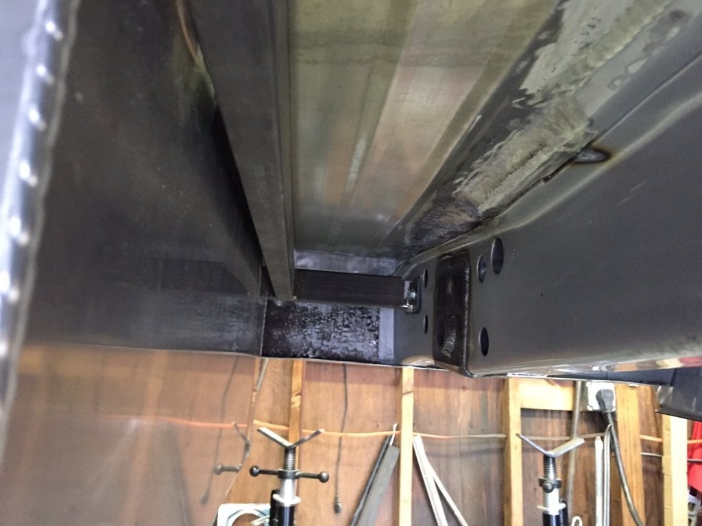

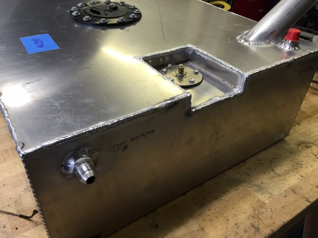

I actually took a 20 Gallon RCI Tank and cut two inches of the top, Moved the vent and return fittings, and added a fill tube. The main reason I did this is I want to run 3" tail pipes out the back. This set up looks trick and allows plenty of room with moved leaf springs and wheel tubs.

Looks like your tank is 20" wide; sitting in the 33.75" clear between rear frame rails = 13.75 /2 = 6.875" clear per side for the exhaust. This compares to 4.75" assuming I go with a 'same but different' 68-70 charger/coronet gas tank.

Thank you and yes I think the 66-67 design with the spare tire well and gas tank arrangement left something to be desired for anything other than a factory restored car. Mine originally being a 318 Poly allows me to do what I WANT to the car without worrying about it. The real issue with my setup is that it's only a 16 gallon tank now so I'll be making a lot of stops for fuel.

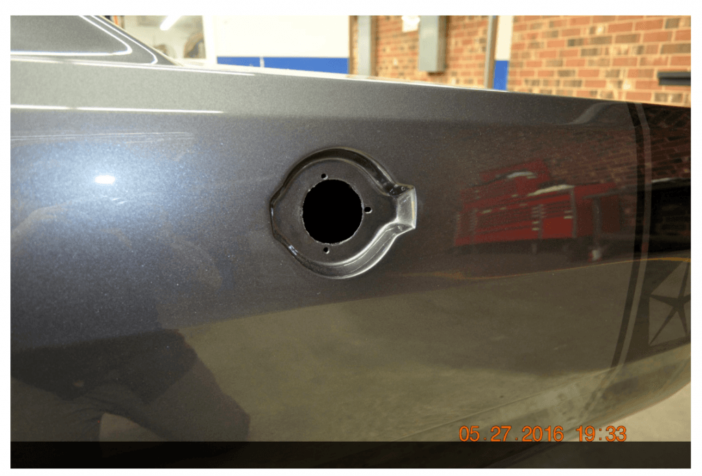

2Quick, Al here again. What's your plan with your fill neck? Are you going to move the factory filler forward on the quarter panel?
So far I rotated the fill tube from 90 deg down to more like 45 deg pointing toward the wheel tub. I will probably cut down my current tank fill tube a couple inches and add a 45 to bring the inlet under the roll bar tube. The rest I'm not really sure of. I did buy a 2" fuel hose that i was going to try and work something with but haven't got that far. But at the end of the day I want to use the factory fill opening in the quarter and somehow get the fuel into the tank thru the inside of the trunk instead of underneath it.
Remember I'm in the planning mode ...... I'll more than likely be looking at either a rear fill or, if I go the side fill, debating the flip top cap (aka GTX, Challenger or Charger) or even relocating Coronet door.

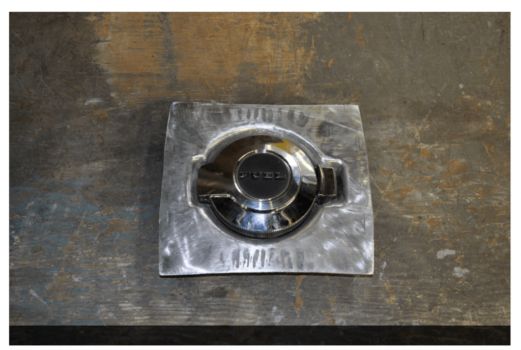

Us Car Tools is restoring a 67 Dart (Jeff's). I attached a few pics from there website that might be of interest to you.
