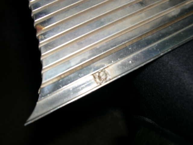

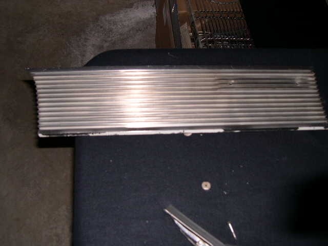

My '63 Fury has decorative aluminum panels on the rear. Some of the 3/16" studs are broke and trying to come up with a way to repair thinking t-studs or carriage studs would do the trick. My concern though is finding an adhesive or epoxy that would bond the studs to the panel. Searching the net I found JB Weld as a recommendation then another post saying this stuff has failed. Then I found PC-7 and Hysol EA 9390 and on it goes! I've posted a couple photos of what needs fixing.
Has anyone done this sort of repair having suggestions?

So the steel stud is broke or the boss is broke out of the aluminum?
I'm not familiar with that part, but in general, all epoxies (like JB Weld or any other one for that matter) will stick very well to CLEAN and SLIGHTLY SCUFFED aluminum. The downside of epoxy is that it's brittle, so don't over-tighten or plan on putting the panel one/off too many times. You could also use a 2-component polyurethane adhesive or even maybe a 1-component/moisture cure (like Liquid Nails) which won't hold quite as well as epoxy, but will probably be plenty strong + has the advantage of being more flexible (in general) than epoxies.
Also, IF the part doesn't fit perfectly and has a tendency to vibrate (?) + you're using JB Weld or other epoxy, then maybe you could put some very thin 2-sided tape behind the part (where you can't see) to take out the vibration/epoxy crack possibility.

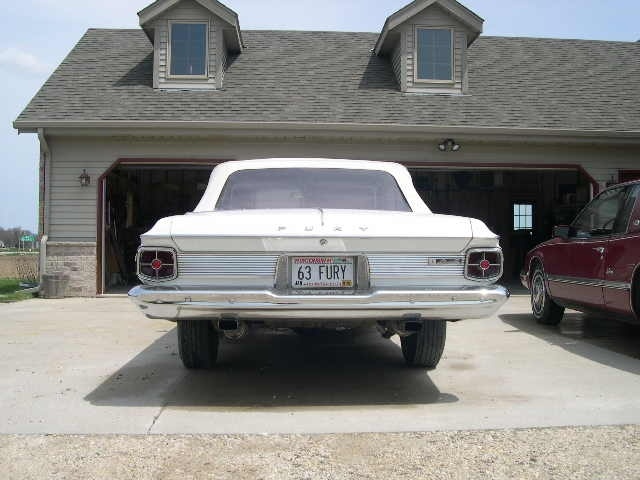

The boss is still intact it appears; wonder how it was affixed to begin with...possible weld of some sort but there is so little alloy there between the channel design. I have a an older pic of the car showing these panels here. Several were broke out when I exposed them so who knows how long they had been broke. This area is subject to lots of vibration I'd suppose and losing the studs could mean a panel left on the highway which is why I'm so **** about a good adhesive or other method. My thought is a t-stud having a longer rectangular base to set in the channel milling out the boss to have more surface to adhere to the back of the panel. Looking on the net there look to be a lot of choices with some minor fab to set T in the channel. As you mention here some adhesives get brittle and this seems to be the case with JB as described as failure to stay adhered in some posts I read elsewhere. I also toyed with possibly drilling out the boss to put a threaded stud in there but so little depth I'd maybe get a thread or so that's about it.
