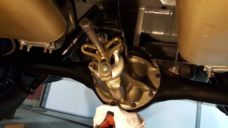

For lochenjons, I think someone on here posted a picture of a tool he made. It was basically a 2ft.+ bar with a plate on the end that bolted to the yoke. That way, the bar would hit the ground & hold the yoke in place while you impacted the nut off. fyi-I've tried in the past with a breaker bar + cheater bar & even with the car sitting on the ground, the tires turned & I couldn't get the nut off.

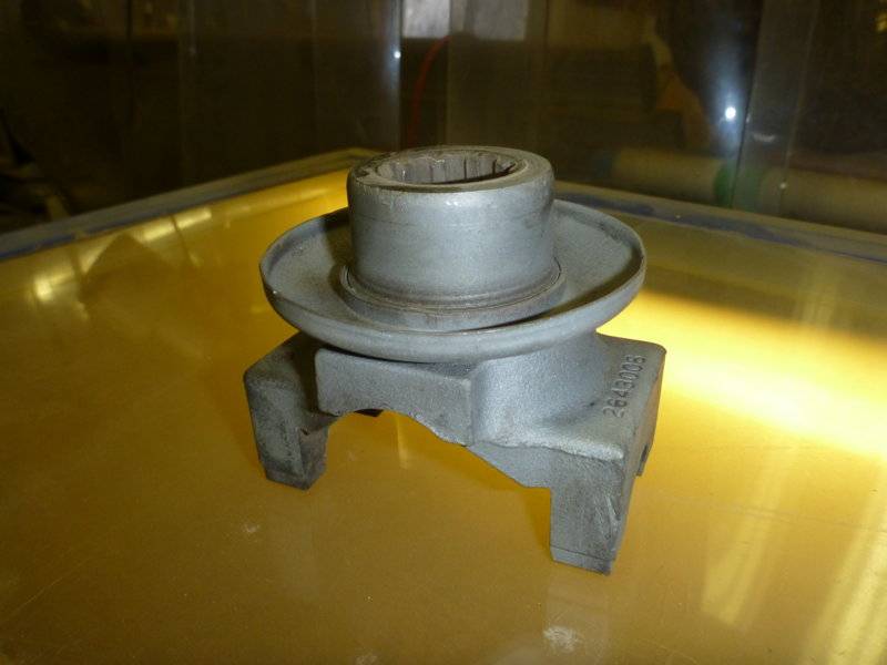

Just make sure you polish the yokes seal surface before reassembly or you'll be doing it all over again.

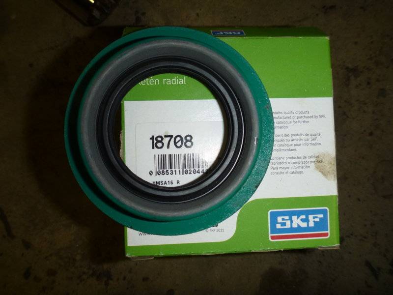

Have had members buy seals at local parts stores leak. If you don't have part number its C/R 18912.

As mentioned clean the surface area on the pinion where the seal rides. LUBE the seal so it doesn't start out dry, the gear oil will then take over.
As an aside, when you get the seal off, inspect the pinion shaft, sometimes there can be a groove worn into the shaft from the seal.
The 742 seal is different. Everyone in my area only had the leather seal, which isn't really recommended. I had to get one from Dr Diff.
Used a piece of angle iron with two holes drilled in it. Impact wasn't about to break it loose. Strong bar and a piece of pipe was needed. I even broke my torque wrench when tightening to the 240 lbs torque. I had it in gear, e-brake applied and tires sitting on blocks.
I couldn't find the seal number from Dr. Diff on the invoice. There are four numbers on the seal that I can't quite make out. No extra metal lip on the new seal.

Looks like 7216 on the seal. If you look it up you'll mostly find that it's the leather one. Maybe contact Cass at Dr. Diff for the double ridge neoprene one.

I bought mine from drdiff but there some on ebay . If you have the seal number C/R 18912 NAPA has them. Guys have bought them from NAPA but they leaked, bet they didn't have a P/N. Tried to buy a hemi front trans seal, no way. Two tries ng called Brewers

That NAPA c/r 18912 looks like a single rib seal. Might be why it leaked. Dr. Diffs has a double rib. Things can't be simple anymore.
