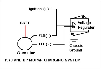

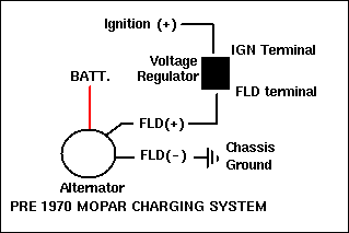

So, anyway, I ran the wiring harness out to the alternator and found that the harness has provisions for the big positive wire and 2 blade terminals(dk blue and dk green), but the new alternator has only one blade terminal. Regulator is the electronic one, not the older mechanical one.
Did a little research on the parts store web site and they show the one blade alternators up to '72 where it changes to a 2 blade plus the positive wire.
Am I going to have to order the newer alternator to make this work or what?
see if this will help.
Yes, 2 different Alternators
1. Square Back
2. Round Back

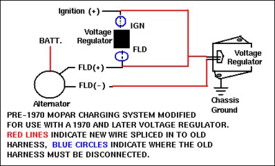

Disregard previous pictures...
This is what you need OR a Jumper (Blade type between the 2)

Yes, the car is wired for the proper dual field alt., but the alt I received from O'Reilly's was wrong. If you do the lookup in their web site, it's still listing the single field alt for a '70. If you put in '72 as the year model, then it brings up the dual field.
Called the parts store, and since I could tell them the problem and since I do about $1000/month with them, they're going to swap me out for the correct alternator.
Thanks for the confirmation, and the diagrams.
