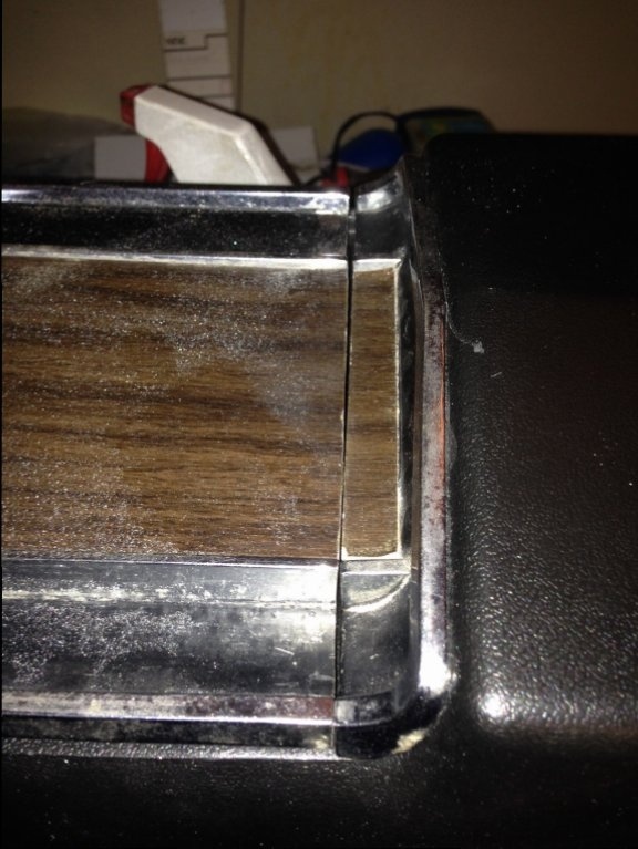

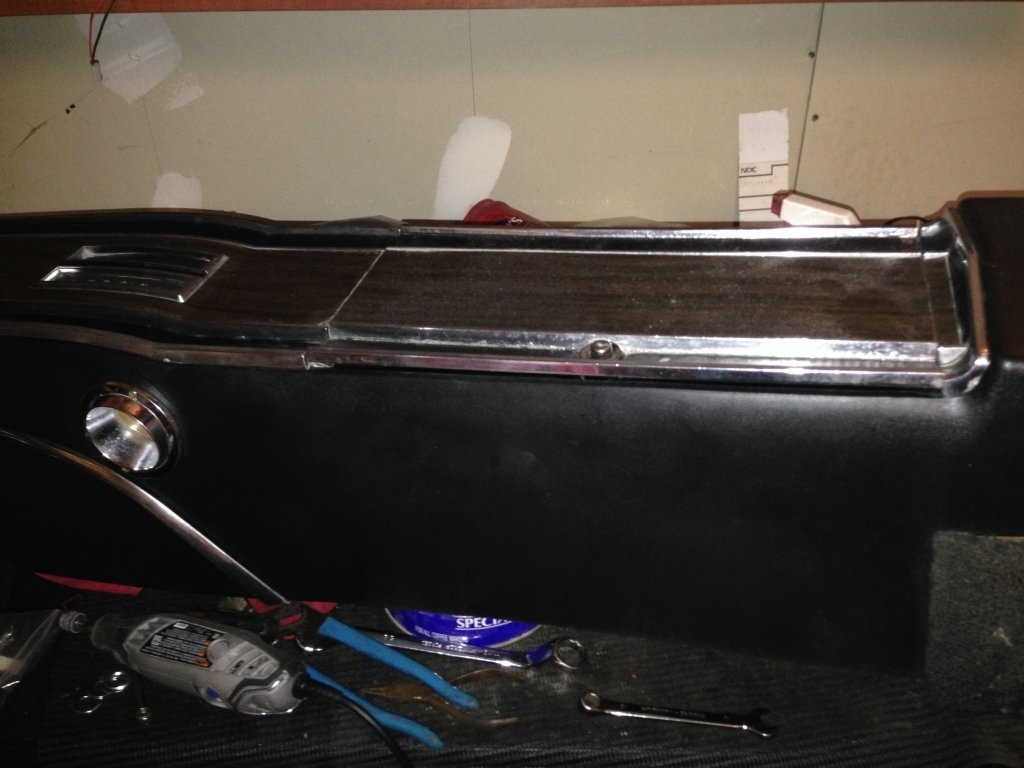

Ok, Got it to open and close took some off the end facing the rear seat. Then it opened and closed fine. But the damn latch hangs on the latch bracket. The sping has been worn out over the years. I wedged a coil I made of thin metal onto the spring end and this now gives it lift. Enough to actually make it pop open once I press the button. I will take some pictures. Remember these are the original top parts with only a new base. And they are not refinished just old and not restored.

I may take it out there and test fit it tomorrow. Hell I got nothing else to do..
The spacing on the lid is not bad. Now adjust the latch to hold the drivers side down a tad farther and you'll be about as close to perfect as you can get.
The latch piece on the inside is adjusted as far down as I can get it without making the slots longer. There isn't any adjustment left in that. So I'll have to come up with another solution.
