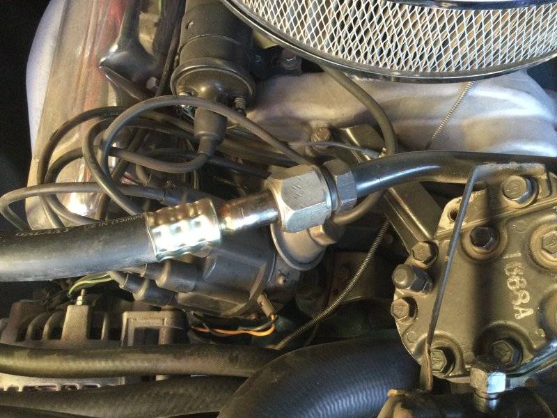

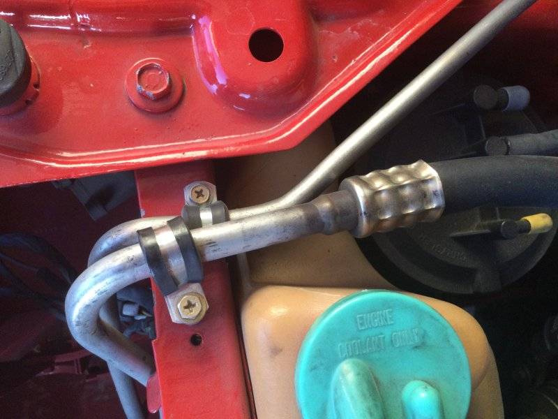

The cost for re-crimping the ends of the hoses was only the labor, about a half hour. There was another charge for braising on barbed ends to the lines and fittings so that the hoses would stay connected after crimping. I used all of my original metal plumbing to achieve the new lines. I live in Arizona and air-conditioning for automobiles is a big business out here. So finding a shop that would do what I wanted was not really hard to find. It really comes down to how bad you want this to go back together again. The cost is irrelevant if you are willing to go the distance.
I am attaching photos of all the connections that Were braised on with new Barb ends. Hope your his helps.
