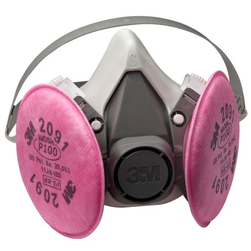

Other than supplied air, I don't know of anything better than HEPA.
But it's not rated for silica dust.
They probably are thinking inside use where concentrations are very high.

Folks, good intentions, however, all these are junk when you're media blasting. I can sell you a used Nova 2000 Helmet/Hood system, heck, I'll even toss in some tear off shields and inner shields too! PM me if you're interested.
Silica base materials are hazardous and as Donny stats a no no without proper equipment there are much safer media's out there for the due it yourself crowd that do a good job. Unless it will fit in a blast cabinet with a water base filter to trap all air born partiicals stay away from silica's. Your lungs will love you for it.
