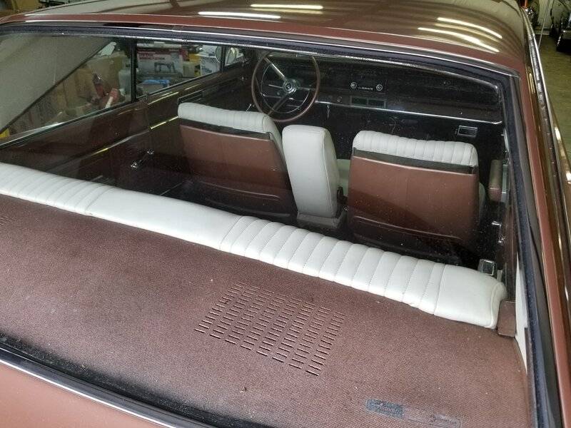

I used Herbs copper dye on all things like door panels, kick panels, package tray, replaced the carpet with Dark Brown original style. I haven't done the dash yet, but the original dash pad is what I consider brown. I thought it was just to much copper so seats and headliner went to an off white.

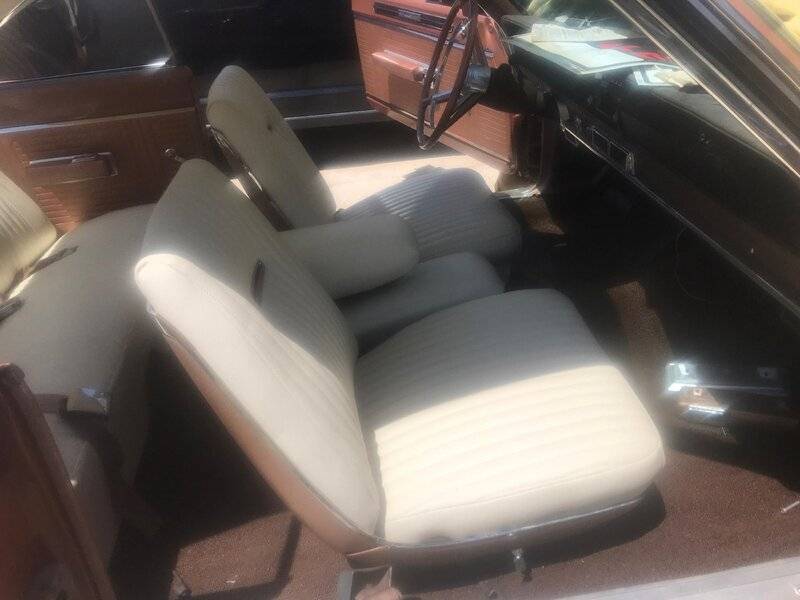

Here's a pic of the original dash in my 67 Satellite with the copper interior. Like Jerry said, I would call it a flat or matte brown metallic. When I had mine redone, the body guy used the copper body paint with a flattening agent. Came out close, but it's not as dark as the original and it has more gloss.

The dash frame in mine doesn't actually need to be redone, but the dash pad does need replaced. I have another original pad with no cracks or blemishes that I am going to do a spray out to see how close Herbs Brown interior paint/dye is to what I think the pad should be. My dash frame is between a brown and copper matte finish and I see no metallic.

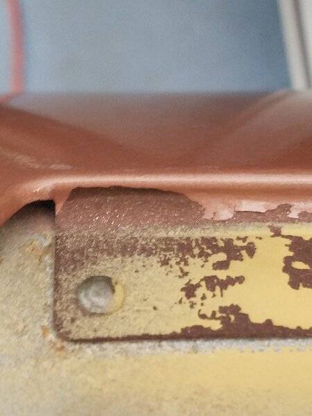

Here you can see the original color on my steering column where the new paint chipped off. Sure looks like it has metallic in it to me - the new paint definitely does (flattened paint code T, Medium Copper Irid.). Maybe it's just my eyes or perhaps Dodge and Plymouth were different?
In 66 & 67 the column was painted body color, with no flattening agent in the paint. I have a 66 EE1 blue car that I used the column to have the body paint mixed.

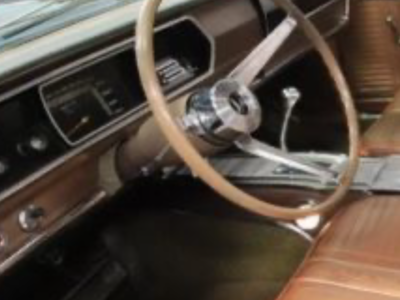

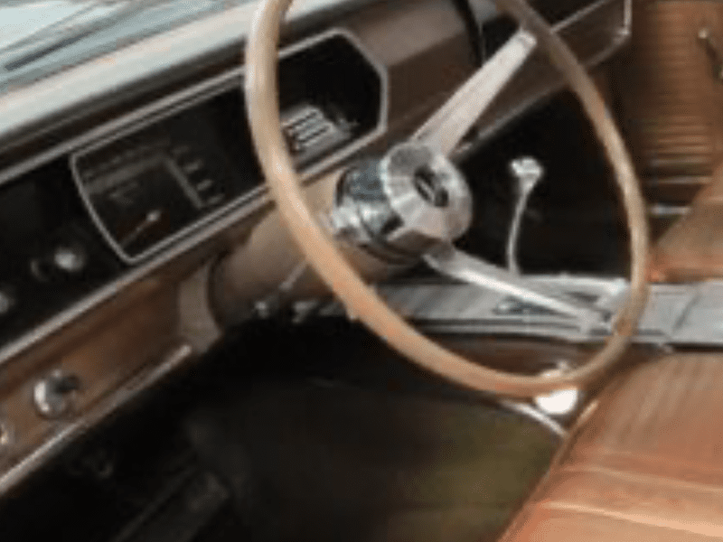

Might have answered my own question above. Here's a pic I found on the web of a 67 GTX Dark Copper ext with Copper interior. Dash appears to be more of a brown or at least somewhere between the 2 shades of copper.

How do you know that GTX dash paint is original or resprayed?
The carpet color is wrong. Look at it compared to the console and the seat, doesn’t go with either. Looks terrible.
66 and older steering wheel, see how much larger the column diameter is compared to the steering wheel center?

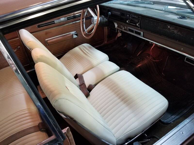

I have a 67 Satellite that I am currently working on, HH1 Dark Copper exterior, and Medium Copper interior. The original carpet had a tag that said Rosewood. Dark Brown carpet is as close as I can get to that color. The console, and dash are a contrast to the seat color but not the same as the kick panels, rear seat shelf, and door cards. The colors blend well, but don't show the same in a overall picture.
I thought 66 had the smaller dia. column. 67 was larger because it's collapsible.
Good point about the GTX as I have no idea what's been done to that car and what is/isn't correct. Don't care for the color combo either. However, the Dark Copper, if close to correct, looks darker than my original dash color which is darker than the Medium Copper so I still think my hypothesis in post 16 is wrong.
